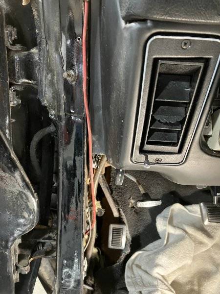

Folks, once again I come here to seek advice. Hopefully at some point I will actually be able to help as all of you do. I am still working through a few issues with the wiring. Today’s effort is in and around the fuse panel. Enclosed are a few pics that show a red wire from the relay mounted the fuse box. I didn’t like how it was run. I figured it was something that was aftermarket and I traced it to the drivers side kick panel. I removed the panel and it ends up at what I assume is a relay and then from there goes up the A pillar and disappears. I believe this car had a security system at some point as under the hood are two spring loaded hinges like doohickeys. Pic of that is also enclosed. So, long story longer, it then dawned on me. I should make sure it has nothing to do with the sunroof in the car. Before I go ripping it out, any idea here? Thanks!
Relay down in the kick panel drivers side
Connector it comes from. That connector plugs into the power window relay on the fuse panel
Leaves the relay in the lock panel and runs up the A pillar.
Picture of what I believe was apart of a pressure switch for security? Mounted on each inner fender by the hood hinges.

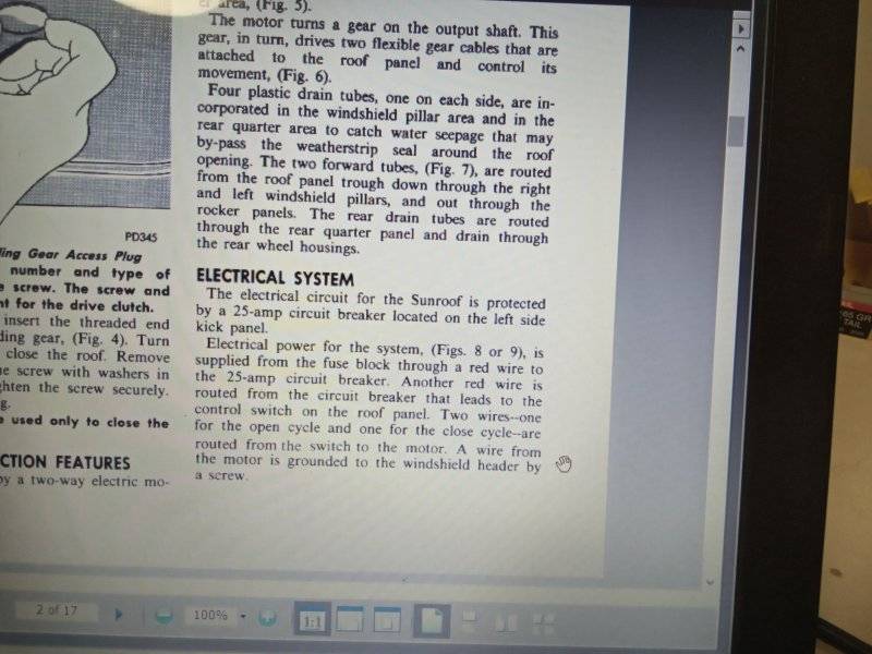

According to my FSM there is a 25amp breaker under the LH kick panel through a red wire. Then another red wire is routed to the control switch.
Gimme a few and I'll see if send you a pic
Ok, wow! outstanding info. I'm glad I didn't do anything yet. That red wire is so short from the fuse block/power window relay over to the breaker in the kick panel I'll need to reroute or replace it. I'll have another look. Thanks much!
