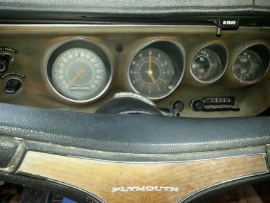

I have a 72 Satellite Sebring Plus. I would like to put a faqctory Tach in place of the clock.
I cant find anything about doing this. Can a factory tach be bought and just put in place of the clock? Are there hook ups for wiring already there or do you have to wire it in?

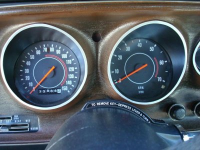

I would like to have one like first picture.
Second picture is what i have now...none functional clock.
Anyone have a tach for this application?

When I added the tach to my 73 SSP all the wiring was there and I hooked up no problem
Reproductions of that tach are available, and is a simple direct replacement to that clock. Tach specific wiring is not in place on a car that didn’t come with a factory installed tach. Simple to recreate however, basically a single wire routed to the coil and power supplied at the dash harness ign. three way tap.
http://www.chargerspecialties.com/tachos.htm
I did my 73SSP about 38 39 years ago and the donor insert must have come with a wiring harness because it was plug and play with no trouble
as I would remember if I had to string more wires
with the diff the repro tachs are 8K instead 7K of originals... mostly sure autometer inners based. Yes, need to add wiring ( rrpro or home made, easy to do ), as stated

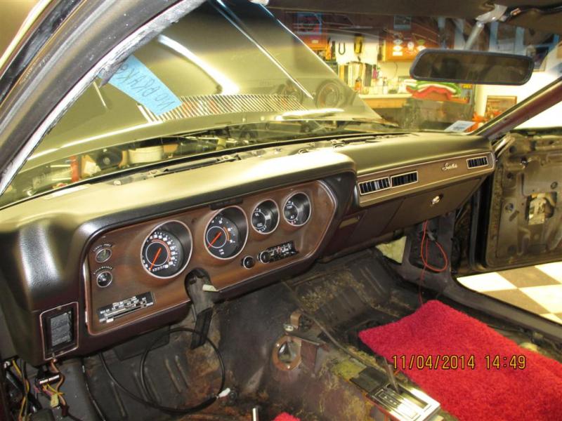

Is there any know threads or techniques talked about on sprucing up the wood grain bezel on a rallye dash?
I read one somewhere where you clean it real good, gently wipe with black paint on a rag to get intot he groves, wipe off, then spray paint it brown...does this ring a bell to anyone????
Here's one: http://www.forbbodiesonly.com/moparforum/showthread.php?16369-Guage-Cluster&highlight=heater control
Another: http://www.forbbodiesonly.com/moparforum/showthread.php?36259-Dash-restoration&highlight=Tamiya
This is the one you're thinking of: http://www.forbbodiesonly.com/mopar...cluster-This-is-how-I-did-it&highlight=Tamiya
