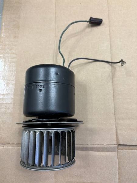

Trying to diagnose the rear defogger setup, of course it worked before the resto of the car and now it doesn't.
I seem to have power everywhere needed and grounded correctly but can't figure out why it is not working.
Just wanted to start with the motor, can you simply bench test it? Black wire to negative post of battery and green wire to the positive post? Or do I need to use a multimeter? Or some other way?
Any suggestions would help, thanks.
You are correct. And be careful of that steel finger grinder.
You can hook it up to battery power.
I’d secure it in a vice or something of the sort when you do.
Otherwise it may hit the floor and get damaged.
If it works, the next thing I’d check is for a good ground.
Your grounding spot may have gotten painted over during the restoration.
Okay full disclosure, lol. I took my original and backup motors apart and just put them back together and they worked. So the motors worked but the unit was not working when installed and mounted. Yup bad ground, looked okay but I sanded away more paint and it worked.

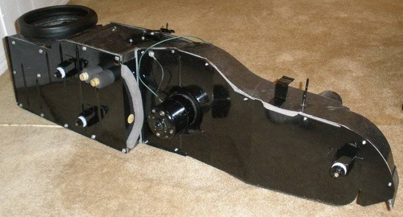

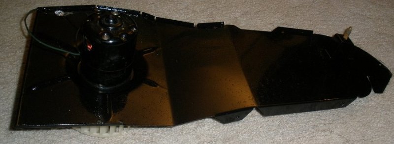

I might have a similar issue with my blower motor. I restored the heater box years ago before body & paint got done, and I could swear by these pics that I had a good ground through the new paint, there's one of those knurled washers that bite in...but my fan doesn't work at any speed. Might have to disassemble and re-check the ground. Of course, the ground wire I have to get at is on the bloody inside...
