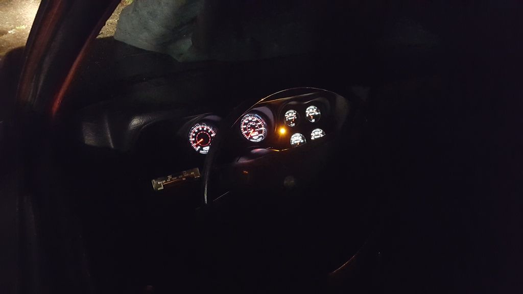

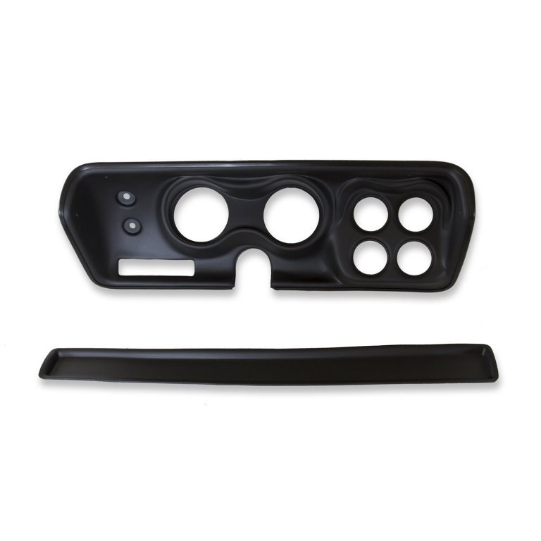

No circuit boards needed, all gauges wired independently. The gauge set used came with all new senders including a hal generator for the electronic speedometer. As for the cluster face installation, It was a decent fit I guess, owner was happy. Some of the glued on screw mounts didn’t line up or came loose after the install. Needed a backing plate fabricated for the headlight and wiper switches to provide a solid mounting and grounding for the electrical functions of the switches.
