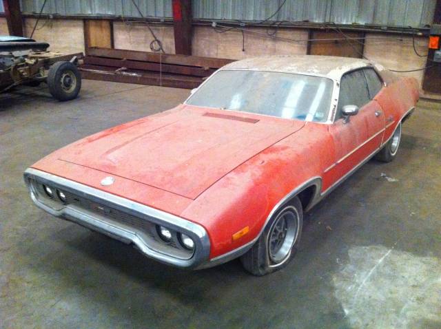

I bought this 72 Satellite Sebring Plus a couple weeks ago. Had been in dry storage for many years. It has a 318. The car has 80,000 showing on the odometer and from everything I see, it is all original. Hasn't been eaten up by rats. Isn't rusty as hell. And it hasn't been hacked up by a dozen different teenagers over the years.
The only modifications to the car are:
Edelbrock LD 340 aluminum intake
Holley 4160 carb. - (which from what I've found out is a 750cfm carb with vacuum secondaries)
and some M/T valve covers...
So anyway, I got it home and have gone through everything to give it a good chance at running once again including:
- I dropped the fuel tank, cleaned it and the lines, replaced the rubber fuel hoses and clamps, and new fuel filters (one before pump and one after just in case) then added new non-ethanol fuel.
- I swapped in new plugs (gapped .035), new cap and rotor, and new plug wires.
- Flushed the whole cooling system, removed the rad and cleaned, new thermostst (180), new coolant.
- Cleaned up the electrical grounds, new battery terminals, soldered any sketchy connections, put in a new battery.
- I took the carb off, soaked it in carb cleaner for a day or 2, lubed up the throttle linkage, got it cleaned up and not sticky... Seems to operate right but I did not rebuild the carb (because, honestly, I really don't know how to).
Ok with all that done, I opened up the choke and hit the carb with a shot of starting fluid and hit the key. It started right up.
It stumbles and dies when the rpm's drop but if you keep the rpm above the idle setting, it runs good, revs smooth, no noises to speak of. So it will not idle but it will run pretty darn good with your foot applying a bit of pressure to the accelerator.
After running for about 20 seconds, you start to notice the smoke. I've got the car in my garage *** first so I can only let it run for about a minute or so before I have to let it die off, otherwise my house is going to get all smokey as well. Now it's not the worst smoke issue I have ever seen, but it's smoking pretty good. I expected some smoke from the car after sitting for so long but you would think that the old dust and nastiness would burn off pretty quick...
I've run it about 5 times for about a minute each and by the time I shut it down, I've got some pretty good plumes wafting out of the garage so I don't think it's just burning off dust and crap... I'm thinking I have more of an issue than that.
I did some reading but didn't find someone with the same circumstances. But it sounds like possibly the carb is making it way too rich possibly or worse, that the valve guides are worn and it's making the smoke....
I never expected it to be perfectly functioning, I mean noone really just parks a perfectly good running car in a huge storage building for over 17 years and leaves it.. There had to be a reason someone stopped driving it, lol.
What do you guys think? What should I look for or try?
