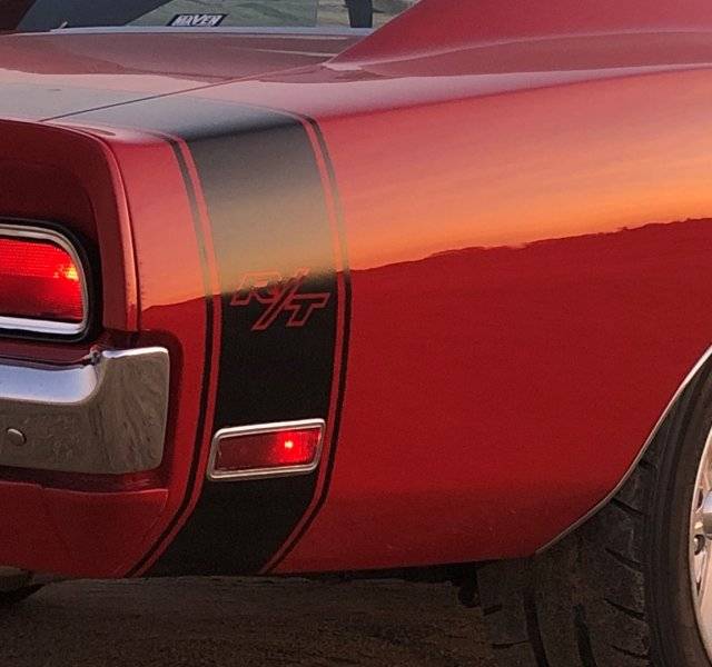

My red Charger is not a genuine R/T but I don't care. I build my stuff to make me happy, not as some long term savings account to cash in on later.
