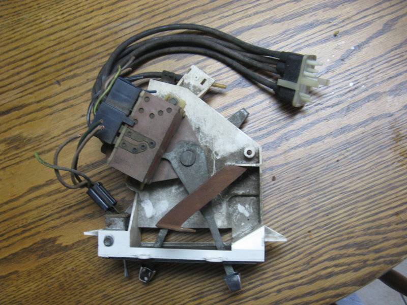

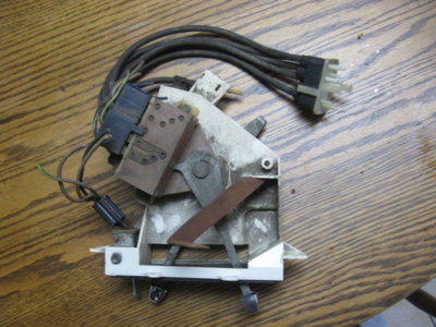

yup
this is a 71 only ac vacuum unit
that came from a rallye dash
72 up runs off electric

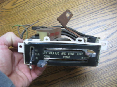

The bracket is different. Here is a 73-4 A/C controller unit from Rallye dash I just sold.

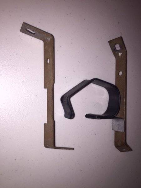

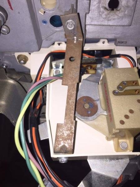

The mystery is solved...at least for me it is. The brackets between the standard cluster and rallye cluster are different. The bracket for the standard cluster has a wire harness holder attached. See the photos.

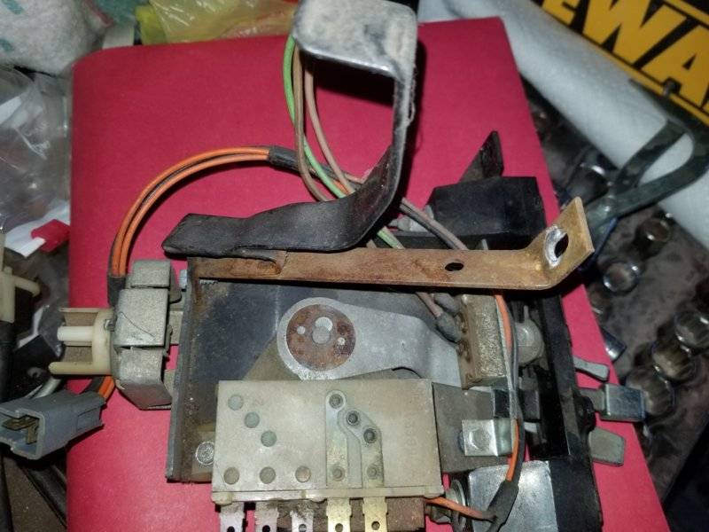

Can you measure the overall length of the one with the bracket?
I know exactly where the one in my pic came from
A 71 se charger
