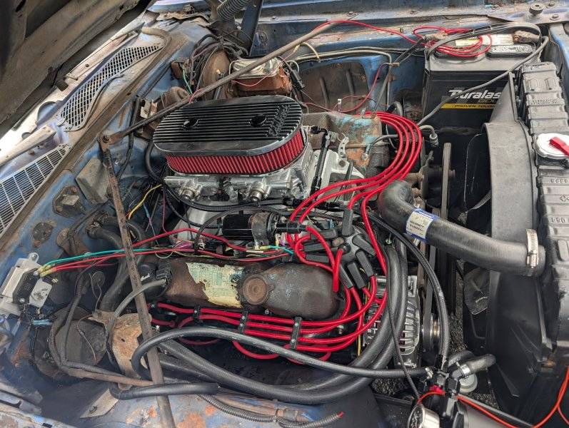

Not factory because all my emissions shite is gone, and I've removed most brackets to clean up the engine bay but I decided on this routing which makes maintenance easier.
Looks good to me and similar to my 70 touring with manifolds. Manifolds I ran Repro wires but had a lot of 90 degree boots

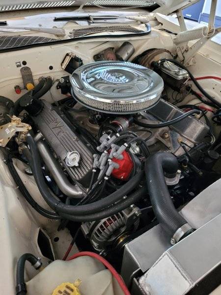

I have also dropped a 440 in my former 318 73 Charger. I route the 2, 4, 6 plugs down past the alternator, under the header, along the inner fender, and then into the plugs from under the header (Hooker Comps). You can do the same with 8 wire, or route it across the top of the engine behind the valve cover and drop it down and around from there. There is no need to chop the fender out. There is more room on the pass side than driver.... so if you figured the driver side out without chopping the fender you can get the pass side for sure.
73 satellite, original 318 car...
For mine I pieced together a few items. If I had it to do again, I would have gotten straight boots. I bought 90 degree boots thinking I could direct the end away from the headers, unfortuantely the wires as they passed up to the holders would work their way close to the pipes and burn.
The Mopar Performance Valve covers photo is more recent, showing the Moroso loom that bolts to the valley pan bolt.
I used R&M Billet Wire Looms for the 440, picked up some double ended Jeep valve cover bolts, and 1/4-20 threaded coupling to raise the looms up higher above the headers.
I added Moroso Spark Plug Wire Separators 72133 for the front holder to shift the wire bundle sideways to clear the top of the power steering pump.
