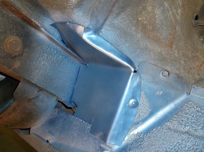

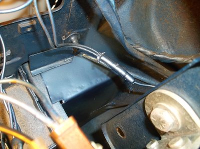

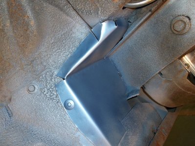

After all this time, and even though I bought a patch piece from a very nice member from here, I decided it would be easier to make up something to block the free flow air to the fenderwell and it worked out pretty well, although a tad sloppy. See attached photos. Thanks again to all who helped me out here.
