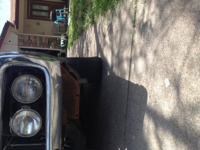

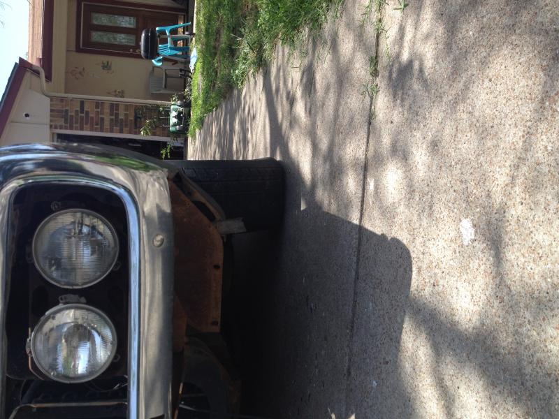

I have a 1973 charger. Never been wrecked. My driver side front wheel is cambered in at top. I have put all new ball joints and took it to alignment shop and they made it drivable, but I'm not happy with it. Anyone else had this problem? I know. Dodge doesn't have the best front ends, but I don't know what's up!!

Well sits the top of the tire that cambered in real bad. It leans so bad it runs on like maybe an inch of tire. Has to be upper control arm bent possibly. I'm gonna see about pulling it apart today and looking at it.. Also pops when then steering wheel.

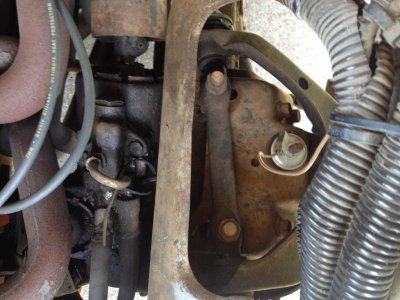

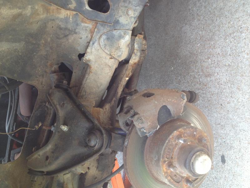

some pictures of all this would help. especially the upper control arm mounting point at the frame rail. these are very easily adjustable. I have a 74 charger and it was about the easiest driveway alignment I have ever done
I'll pull charger out today and get pics and see if I can post them.
Also when I raise the car and take weight off it straightens up, I was looking and I think the front has been lowered because headers don't have much clearance

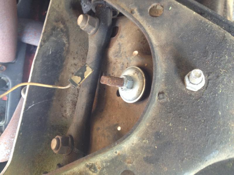

im betting your upper control arm bolt(s) are loose and letting the A arm slide around. that rear bolt adjuster is all the way in, which why your tire is leaning in. you need to loosen the rear bolt, and slightly loosen the front one, and with the tire on and in the air, pull out on the top, until the wheel looks straight up and down. I cant believe an alignment shop could not figure this out.
these bolts have to be TIGHT, but don't break them. I use a cheater on my ratchet when I tighten these.
this adjuster should be about halfway out or so , all cars vary, but its a good starting point. from the dark spot, it looks as though it was all the way out and has moved.
it is easier to move the A arms around with all the tension off of the torsion bars, but then you will need to reset the ride height after you get the wheels straight up and down. then reset the toe. make sure you do this on flat garage floor or pad.
