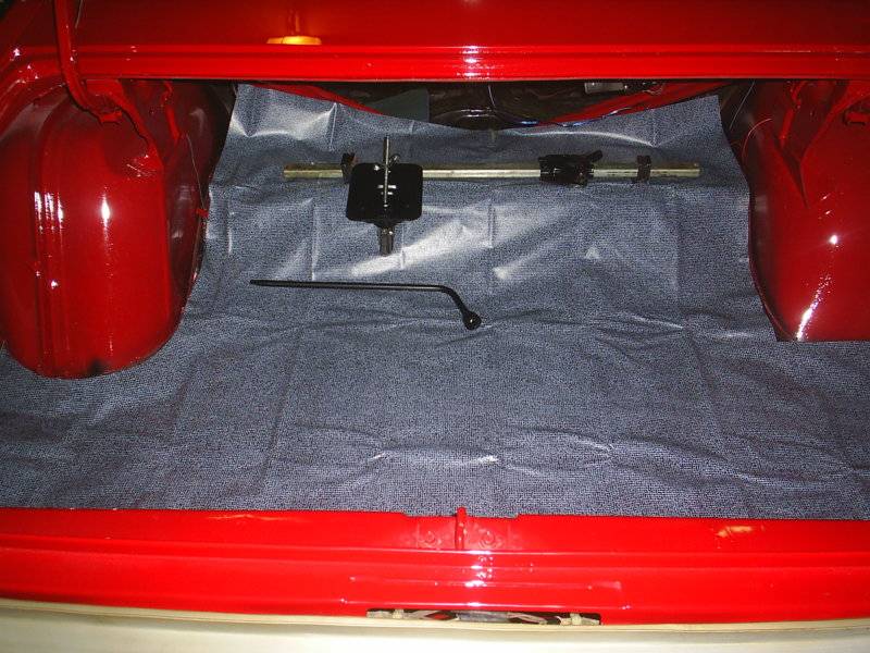

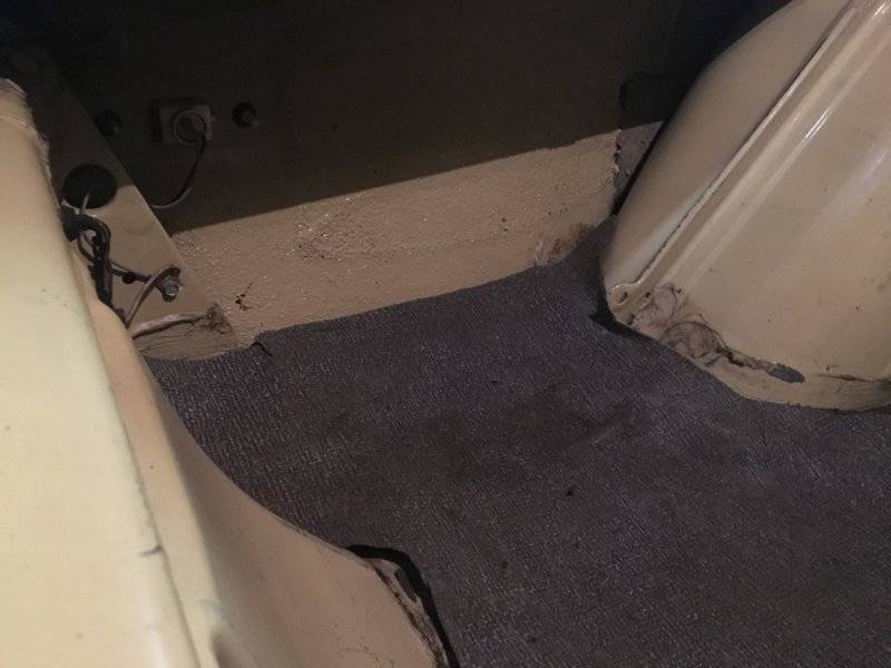

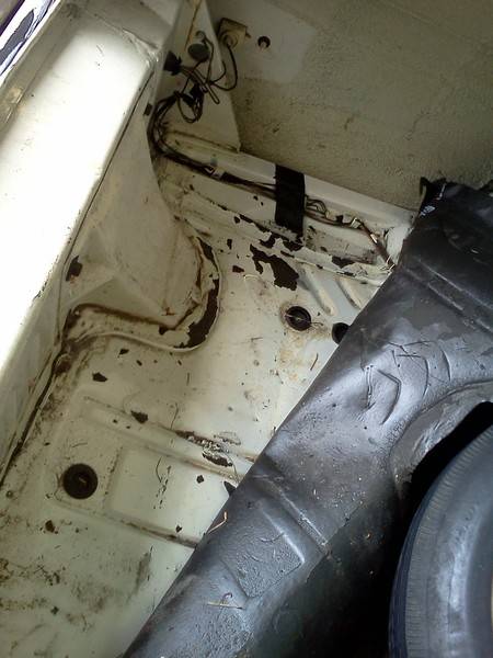

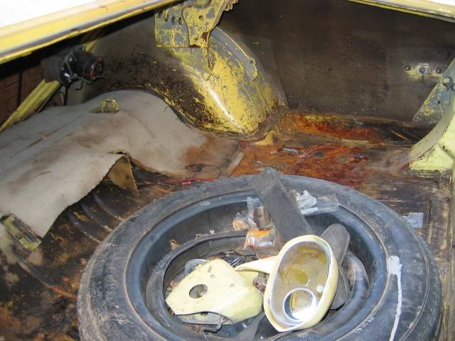

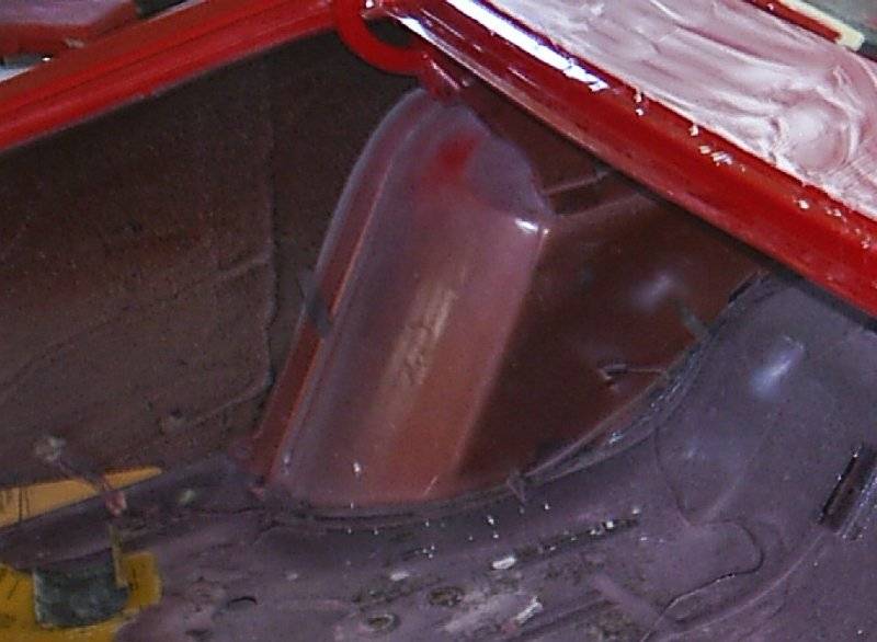

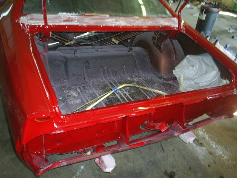

After paint but no work done to trunk Don't know if it's much help.
View attachment 705351View attachment 705353

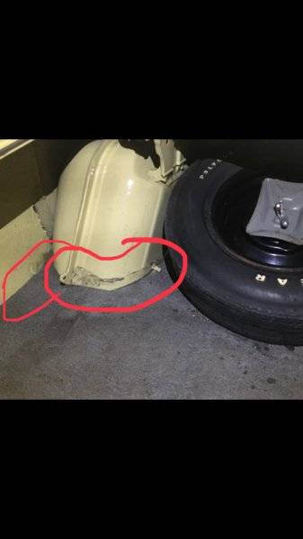

Did Dodge / Chrysler use an adhesive
Sealant where the floor meets the quarters ?
I guess what I’m asking is , does it look like someone schmeered caulking on the joint and up on the inside quarters , then factory paint on top ?

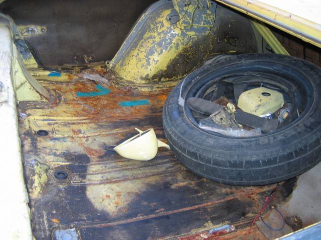

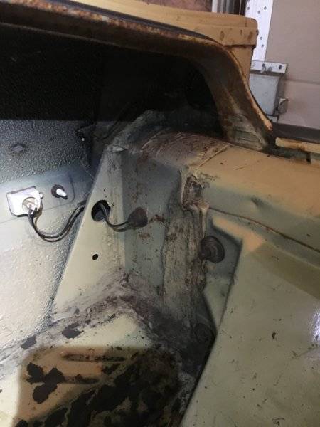

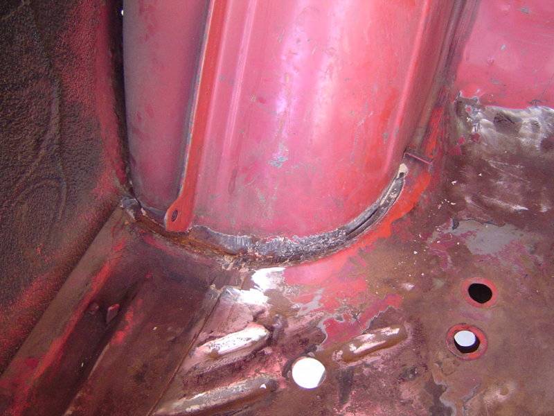

Seam sealer around the wheel wells, trunk extension and along the channels for the trunk lid.
Here is what it looked like along the extensions and wells when I was stripping it down, you can see where I removed it. The quarter panel to trunk channel was left untouched in original condition as there surprisingly was no rust there.
By the way, the body service manual will show you where the sealer goes on the entire car!

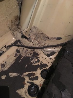

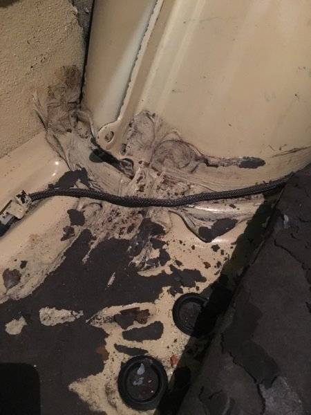

If anyone else has a photo of the inside of theirs I would appreciate seeing it thanks again guys

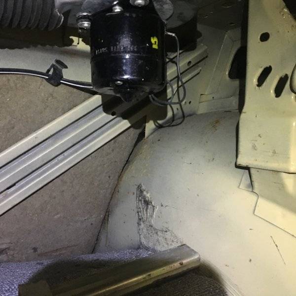

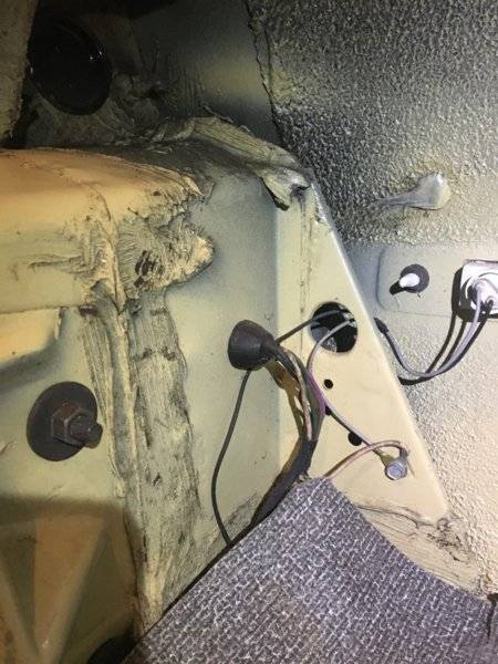

I’ll post a few pictures of mine later
Yes, that is exactly what mine looks like. A lot of goo at the seams, filler or seam sealer sprayed over.

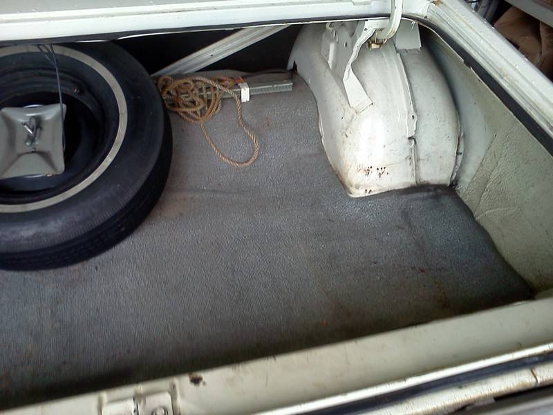

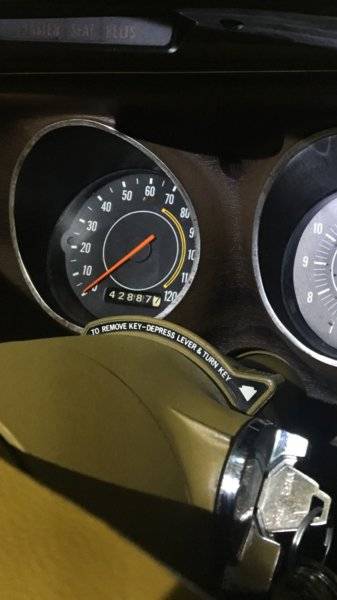

54,000 original mile 73 Satellite-
