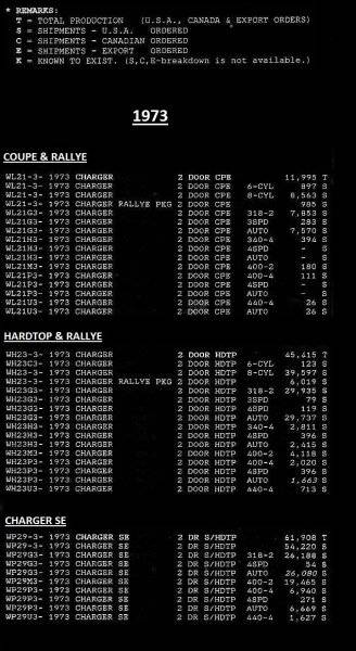

I have been trying to find out the history of my Charger. Does anyone know where I can go to get the history for this particular car? Also, does anyone know how many triple black 1973 Charger SE's with the 400 high performance engine were made? Any info will be greatly appreciated! Thanks!!
According to what I have it says 6940 73 Charger SE with 400-4 BBL were made, 6669 were auto and 271 were 4 spd
Supporting this:
Thanks! I will definitely do that!
