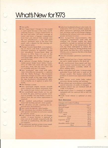

All 4 bbls for 73
But I'm pretty sure for WHATEVER reason 440 4 speeds didn't get them at certain point
