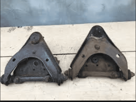

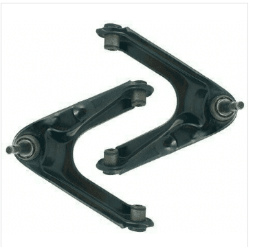

Hello, I'm working on a 1973 Charger that was involved in a collision. It bent the upper control arm and today we received the new control arms. The problem I have is that the original control arms are shaft style and the new ones have the bushings pressed into the arms where I would assume is would require individual bolts vs the cross shaft? Or is it just the wrong part? Can't seem to find any new arms that use the shaft, all seem to be the style I received. The new arms come from Classic Performance Products but didn't have any instructions or additional hardware to convert. Any advice appreciated.

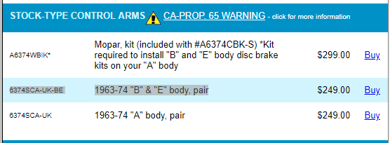

5 years later their catalog is still incorrect. Those arms fit up to 72 b-body and up to 74 e-body.
It appears no one repops those arms. you will have to find used ones.

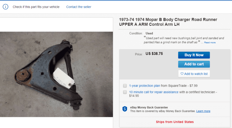

I may have a pair of arms in my stash as well, but $38 aint a bad price
.....they are different left to right
Thanks for the responses. I since learned about the two different control arms depending on model year. I already contacted the company who claims to "have never heard of this before" LOL I ordered a used pair on Ebay and new bushings, ball joint to make it good. thanks for all the advice! I'm sure I'll get my money back from Classic.

We should probably also say that "sometime" during late 73 production the deign changed to a press in UBJ
so be careful or at least aware so you don't end up with mix matched arms or ball joints you can't use

I have a pair of what I believe are '74's.
Was kind of holding on to those just in case.
Are the ball joints pressed in on those? Any chance you could send me pictures?
