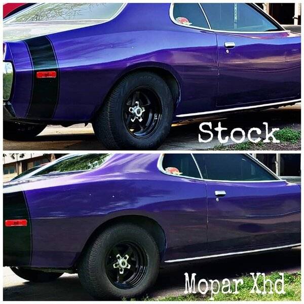

i like them.. my before and after pic. its not drastic, but its not sagging no more either
