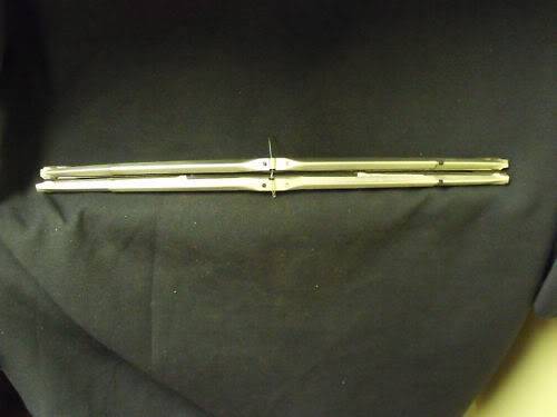

ok guys. i was wondering what wiper blades you used on a 73 charger. seems like everyones i look at are too tall and hit the hood. they will not clear. ??
I simply hunt down refills and use the original Aanco blades.
If your factory orignal blades are MIA,there should be plenty still in old Mopar yards to score and replace the refills.
They are 16 inches long and have the "red button" on them..

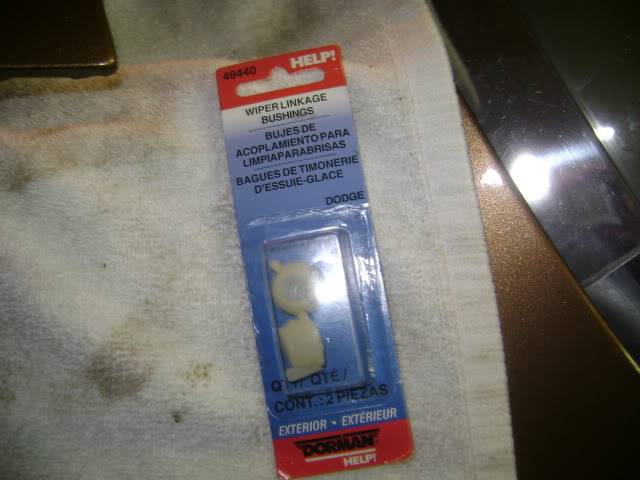

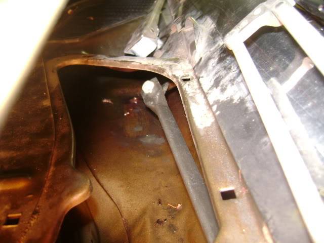

Besides using the incorrect blades that hit the hood puts stress on the wiper trans and eventually wears out the plastic bushings.

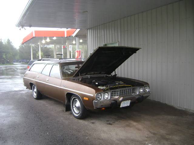

Been there fixed that on the road..in the rain..an hour away from home..
