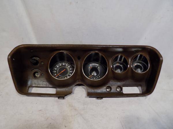

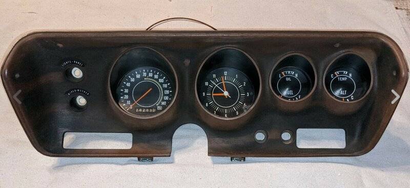

There are 2 kind of Rallye cluster with 3 variations.
The basic one
And the one with clock or Tach, either one, cluster is the same but the gauge interchange.
These both kind of cluster gets a diff housing, gauge meters and lense mask and don't interchange between them. Well, you can phisically fit the lense mask but won't match the gauges disposition. Allong with the hole for the clock adjuster shaft. Wood grain bezel is not affected about this thought!
Housing is actually also molded/casted for both cluster dispositions thought, but still drilled and cut for one or the other setup.
All 71/72 are 150 speedos. 73/74 are most of them 120 speedos ( first one I posted is 74 with 120 speedo ), but you still can find some with 150 speedos ( most of them on 73 clusters ). Speedos are interchangeable thought.
