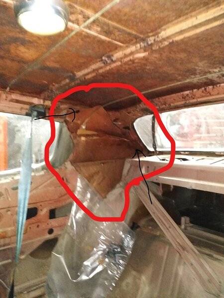

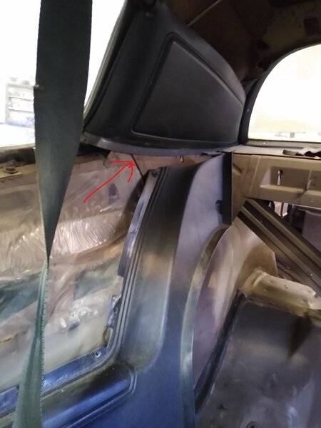

So a I continue to tear down my car I continue to have questions..... On the rear pillars inside there are cardboard looking panels attached to the body with black push pins. From what I can find they may be called earmuff boards. ( see pictures ) They are sturdier than cardboard but after almost 50 years they are falling apart and so brittle they can't be removed intact.
They extend from the roof area to below the lower trim panels and have cutouts in them for the "teeth" that secure the headliner. BTW, thanks to Builderguy for finding me the correct headliner!
Any supplier I have checked does not seem to reproduce them and I don't thing cutting them from cardboard would work out too well. The '68 and '71 I restored previously didn't have anything like them.
Helpppp, ideas?

Those are your Sail Panel Boards John. It looks like Classic Industries has them listed in their catalog. It says they are plain uncovered panels ready to cover in your choice of materials. May not be what you were hoping for but you can check them out @ classicindustries.com

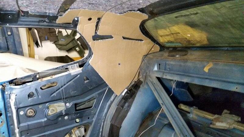

My 74 Charger had them also and I couldn't find the correct replacement anywhere. The ones being offered as reproductions are not even close. I made my own out of a heavy cardboard and I glued on insulation. The originals had an asphalt kind of material in them. The ones I made worked great using the originals as patterns. The first photo is the original. The second photo is what I made.

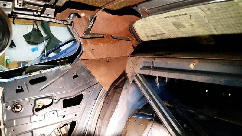

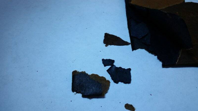

Yes, they were in my Charger. As I said, I made an extra one because I have another 74 Charger and no telling if the ones in it are usable. Here's a closeup photo are what the panel composition looks like.
