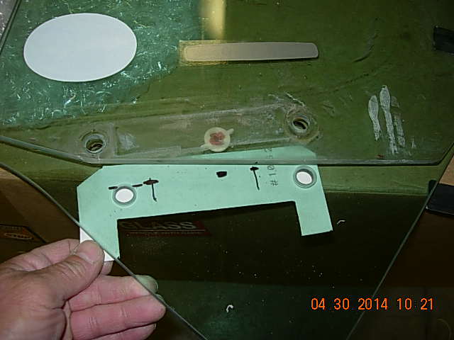

new roll up windows. Where did you buy those or did they come on the car? Anyway, here is how I did it:

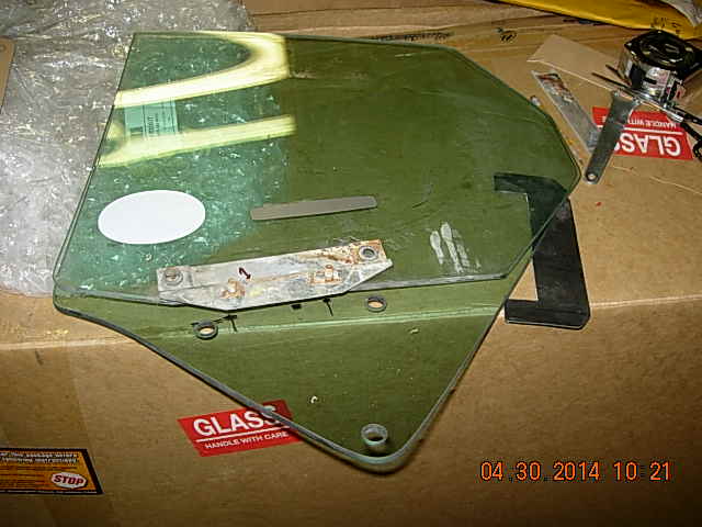

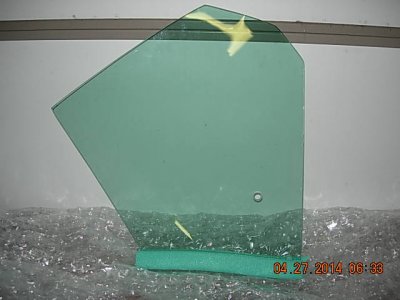

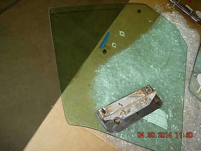

This is the quarter window I purchased already.

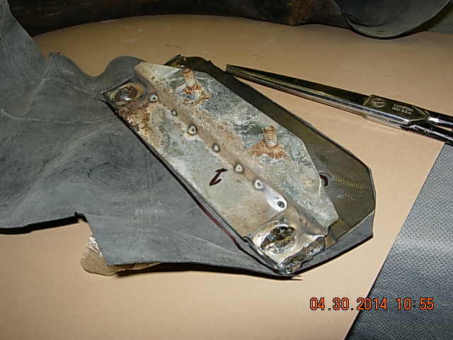

I placed the old window on the new with the bracket and marked on the new where the bolts that hold the window to the body should go after I was done modifying my old bracket.

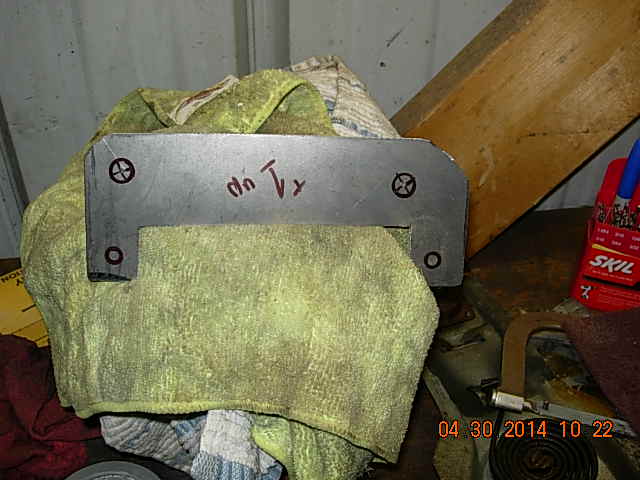

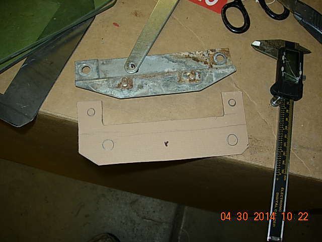

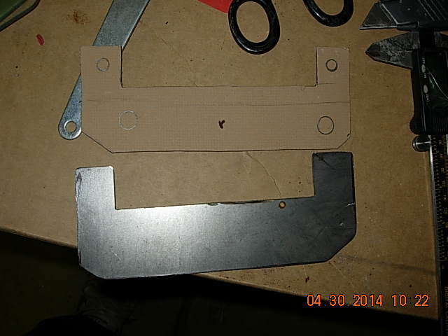

I made a template that I would use to cut out 2 metal brackets to use for the new windows.
I made sure that the template was correct and put it next to the old bracket.

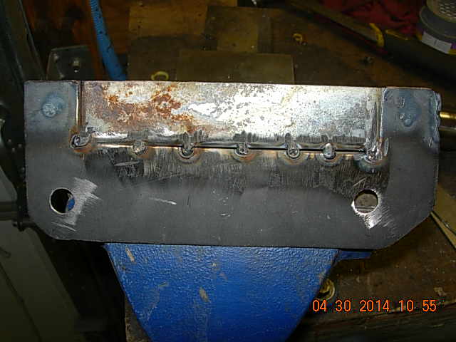

Using the template I cut 2 metal pieces to weld onto my old bracket.

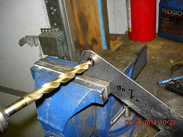

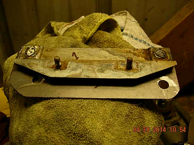

With the template holes drawn onto the metal bracket, I needed to drill only the holes with an "X" marked on them.
I drilled 1/2 inch holes that matched up to the window holes where the regulator would attach to.
This will be where I attach the new bracket to the new window.
Next I welded the new brackets to the old ones.
Both the front and the back and then ground down the welds to make sure they where flush with the bracket.

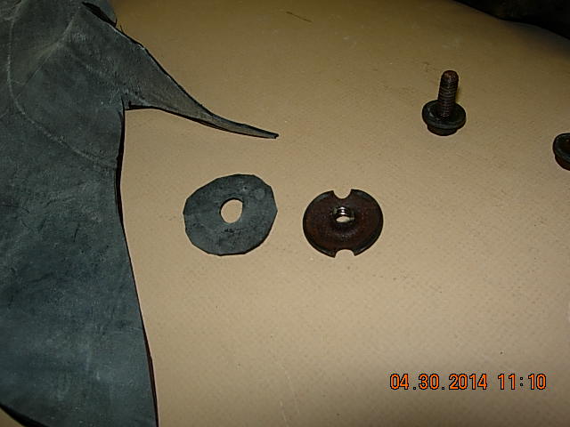

Next I used an inner tube to cut new gaskets for the brackets.

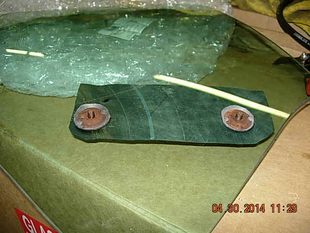

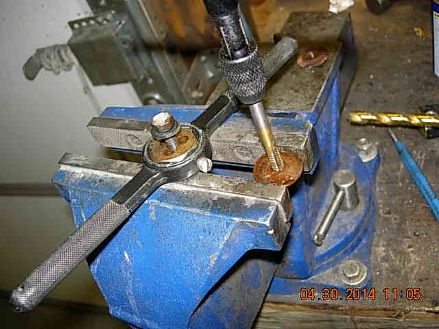

I tapped and died the metal pieces to use again for the bracket attaching to the glass.

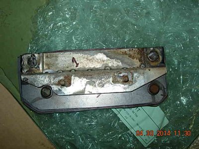

I lined up the bracket on the glass and the next pictures shows the newly made bracket installed.

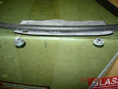

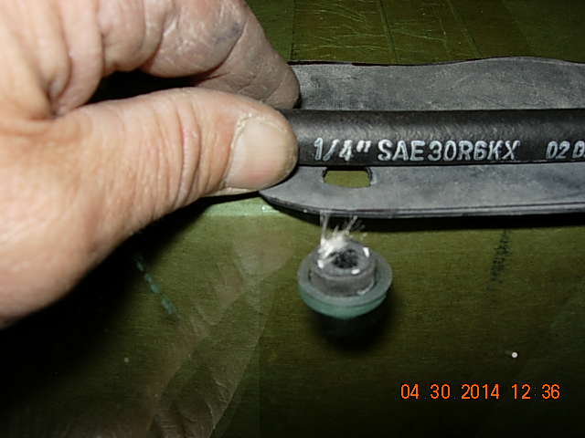

While I was installing the brackets, I needed to place something in the holes of the glass
to snug up the bolts so I used pieces of 1/2 inch fuel line cut to length and placed them
in the holes for added security and non movement of the glass when installed in the car.
