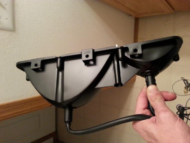

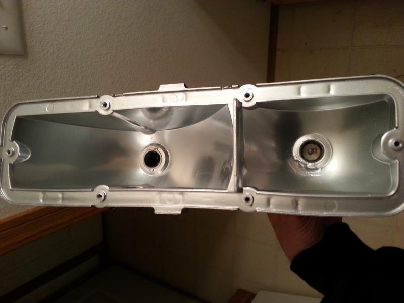

So, I cleaned up my set, removed the rust from the sockets with small wire brush on a dremel, cleaned the pins, sealed the cracks around the socket with JB weld, and re-sprayed both inside and out, and re-wrapped the wires with cloth tape. They are working well, and brighter with the chrome paint on the inside.
Just a FYI, I used Dupli-color adhesion promoter followed by dupli-color Chrome paint, after cleaning the inside of the housings, same on the outside except used a satin black.
