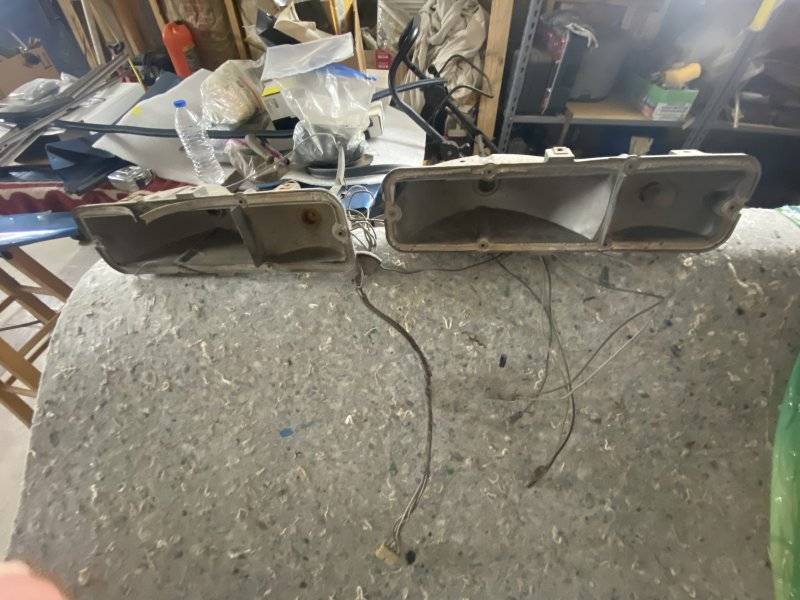

Are you looking for these?
If so I have the one in this photo you can have. They’re not in perfect condition but you might be able to make a good pair out of yours and the ones I have.
The bumper doesn’t need to come off to remove taillight housing. The bumper filler can be gently pushed out of the way if needed and doesn’t need to come off either.
