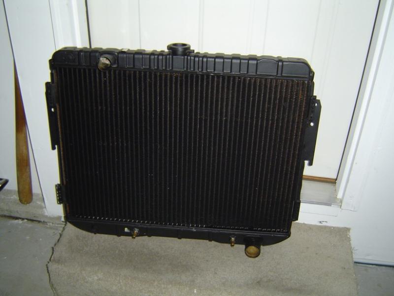

I did a lot or reaearch on this as my 73 Roadrunner has a 28" radiator, part number 3673028, and here is what i found.
First, 1-800-Radiator could not find one so i contacted a local Vista pro shop and they found one that was brass, but it arrived damaged. I spoke with my radiator guy and he could only find the plastic and aluminum ones. Next, and believe it or not, Oreilys Auto parts actually found one in a warehouse that was correct. Most of the replacements now made are plastic and aluminum and the part numbers are the same on these and the ones that are brass.
The direct replacement is a Spectra Premium CU504, but that one is discontinued, so CU510 will also work. The one i got was a Ready Rad 433510 from Oreilys.
I tacked on a picture of it. It appears thinnner then the original, but that is because my tanks on the original were designed to go on a 2 or 3 row core, my replacement is a 2 core. the top tank has bumps a bit higher where the inlets connect, but i did a test fit and should not be a problem.
I wish someone would start making the correct direct replacement again, but this is what i found.
good luck, i hope this helps you find one.
