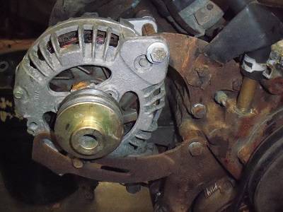

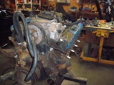

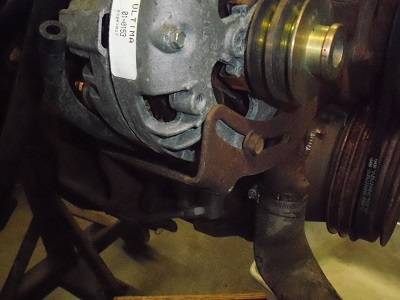

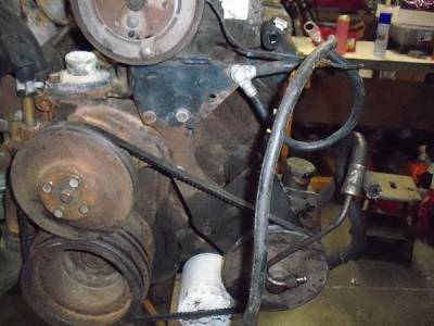

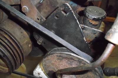

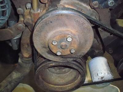

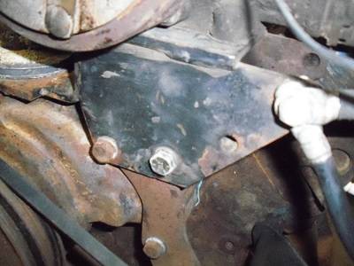

this is a 76 440 truck /MH set up
I have a 76 400 car engine also still together if these pics dont help.

That's exactly what I needed! I forgot to post a thank you!!
Looks like that's is the later A/C compressor - the Nevill one. Does the 400 have the older V type AC compressor or same as this?
Its the same AC on the 400.
That's a goofy aftermarket ac.
The other alternator is a big 100amp unit with a huge bracket to secure it
