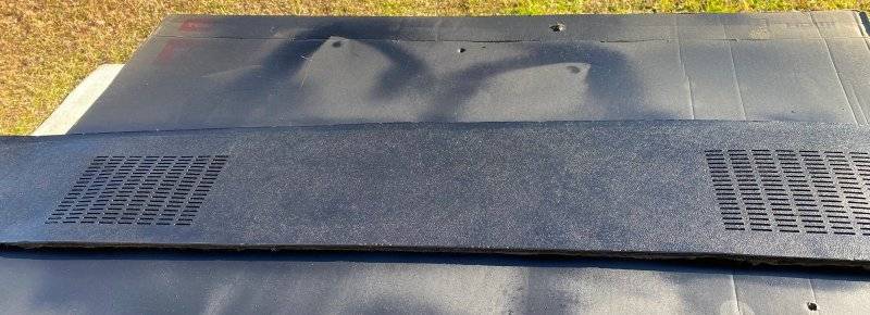

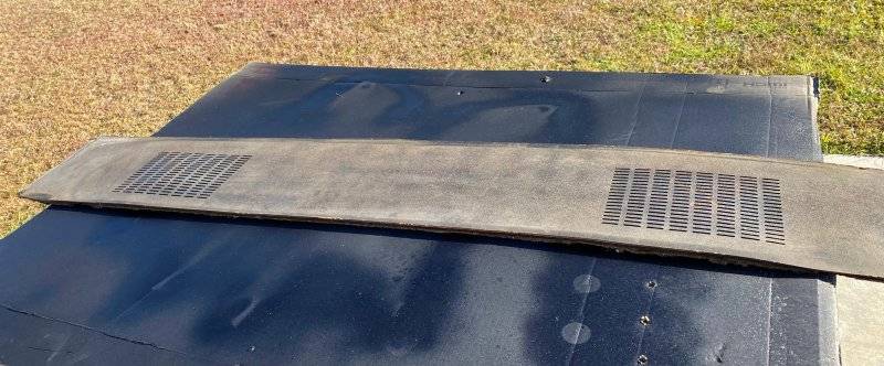

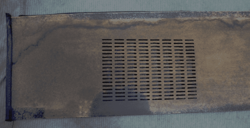

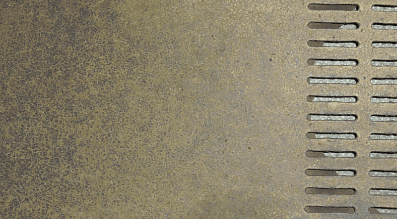

What is the best route to restore the hardboard parcel shelf? It used to be black :). It's also somewhat hardened and the nicely grained surface is easily chipped. What type of paint and how should the hardboard be treated before painting?

I painted mine with SEM landau black. Took a few coats as it soaked right in.
@74ChargerSE440, on original cars in which the package tray is still good, just faded, I have used black shoe polish in the paste form. Just use a soft bristle brush or piece of soft cloth to apply the black shoe polish. Depending upon how faded, will determine how many coats it will take. Between coats, use a soft rag to buff the coating. Using this manner, you can leave the package tray in place and not risk breaking it or the interior window trim. Does not get chalky or slick like some paint does.
