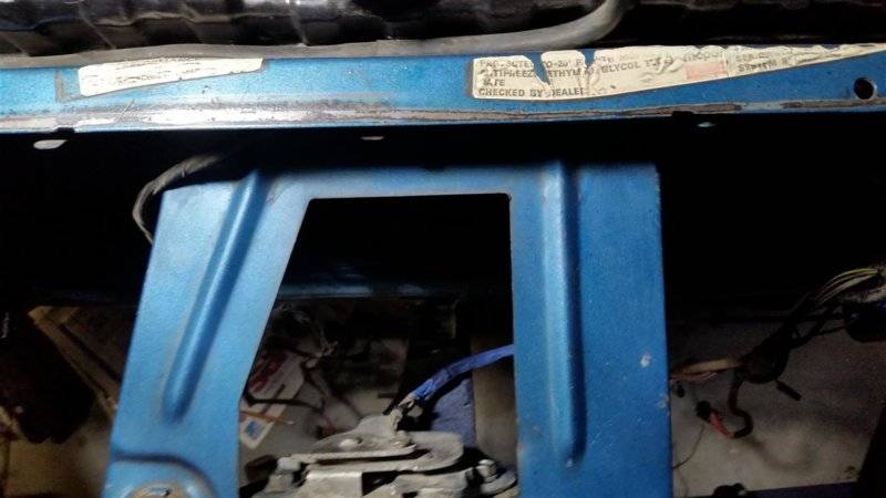

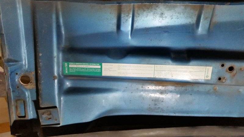

Here's a couple of stickers on my 74 Rallye Charger. These are original. the first is the Emissions decal located on the bottom front passengers side of the hood. I don't know if you have hood pins or what to take measurements off of. This is a bulge hood. The second photo has two decals in it. The one on the right is the Antifreeze decal and as you can see, it was just slapped on the upper radiator support in front of radiator. The decal on the left is: For Optimum Performance Use Genuine Mopar Parts decal. These are both original and I included the hood latch bracket so you can see where they are placed.

Where does the coolant reserve addition decal go it's green and white? Or does the 74 not have it. Thanks for your reply terry
My car does not have a coolant reserve decal. That's not to say that 74s didn't have them, just my car does not and I do not see any evidence one was there.
