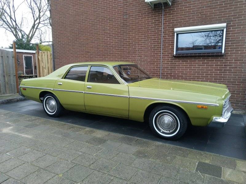

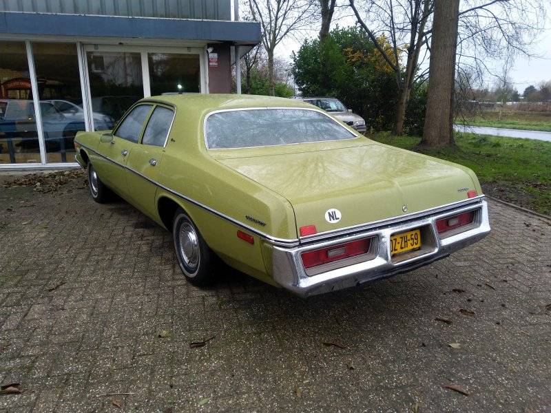

Maybe not a real project or body-off restoration, but I'd like to share the progress I'm making with my Dodge.
There's a lot of small things to do before I can drive it properly for the summer season.

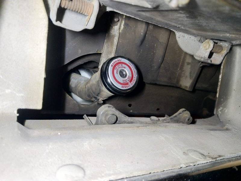

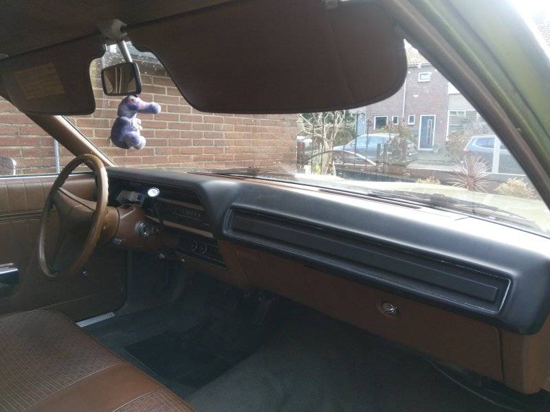

First I removed the reflectors and sticker from the trunk lid and removed the silly outside temperature gauge from the dash, I think it looks much cleaner now.
I also installed the side marker lights, since they were not even installed and fixed all the other outside lights.

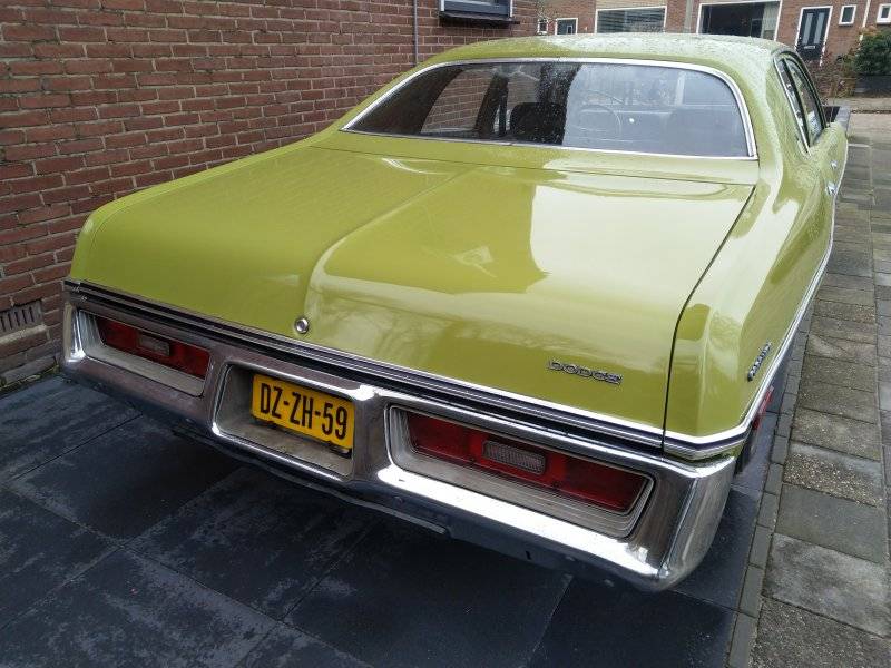

And last week I bought some nice white line tires.

Dude, your car is SWEET! That 225 cid inline 6 cyl will outlive cockroaches after a nuclear war. Those engines are indestructible and have more torque than you’d guess.
That is an interesting color.
...especially with a brown interior.

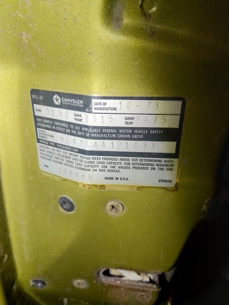

Fender tag still on it?
Yes! I even got an organizer with it with al the original papers in it. It was sold by Chrysler Belgium.
It was repainted, but I think I like this color better.

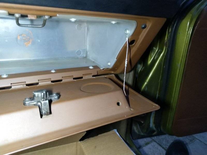

Repaired the cable which holds the glove compartment lid.

Installed a new fuel cap, which isn't a big deal, but I found out that the license plate cover opens the wrong way around, so I have to fix that also.

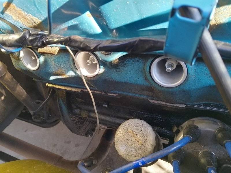

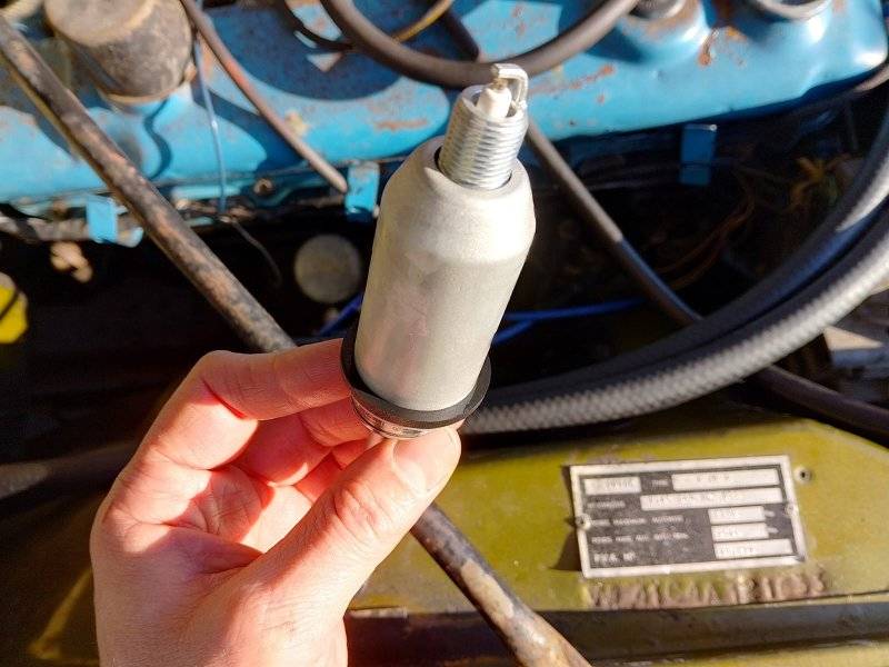

Sandblasted the sparkplug tubes and installed new seals and plugs.

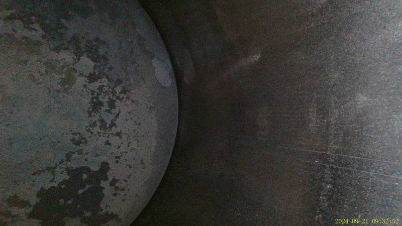

I borrowed a videoscope (is that the correct word?) from my work to check on the cylinders, and I think they look pretty good for a 50 year old engine.

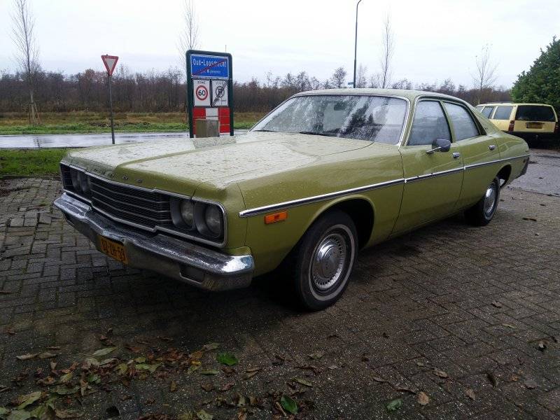

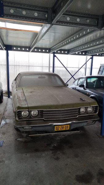

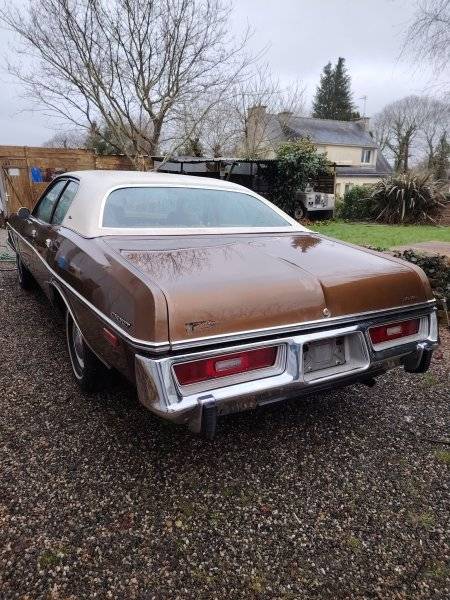

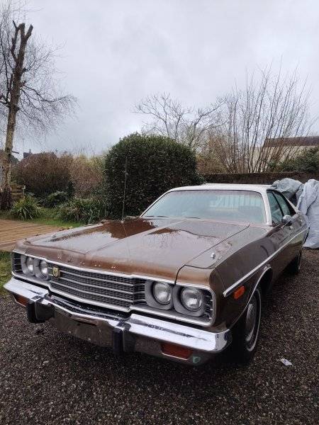

And I got a picture of how the car was found after being stalled in a trailer warehouse for 30 years.

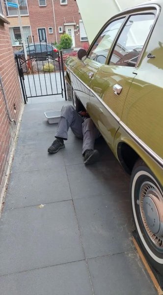

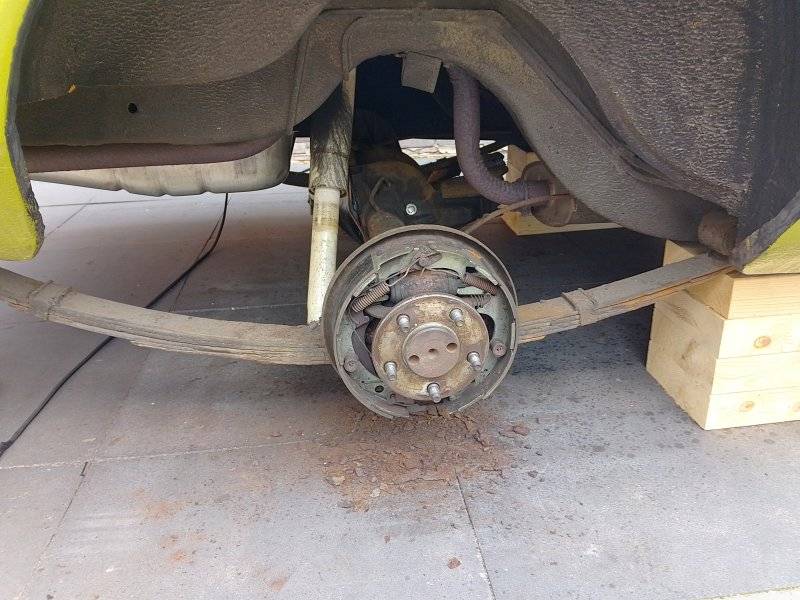

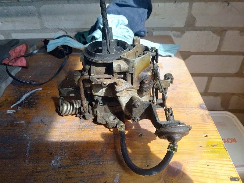

Just a little update, I still haven't driven the car properly, since there is a terrible scraping noise coming from the back end. I thought it were the wheel bearings, but it turned out that it came from the differential bearings. So I pulled the axle assembly from underneath the car and will replace the bearings. Also all the other parts, like new bushings for the leaf springs, dampers, brake lines, etc.
I also did a few other things before all this, like the front wheel bearings, transmission mount and a new battery with new clamps and cables.
The car also stalls when accelerating, so I will also overhaul the carburetor and change the fuel pump. I will keep it all original.

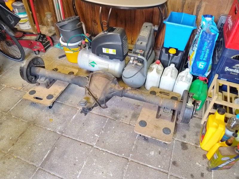

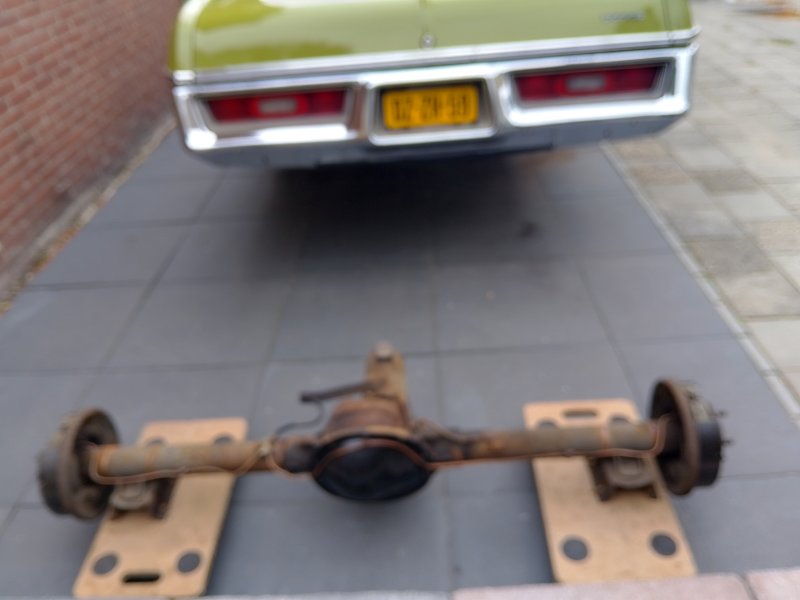

So now, the axle assembly.
Little rust coming from the damper and leaf plates.
Dragged the axle to my cramped barn.

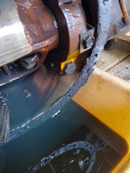

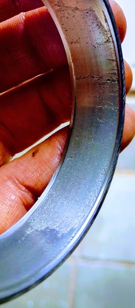

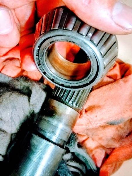

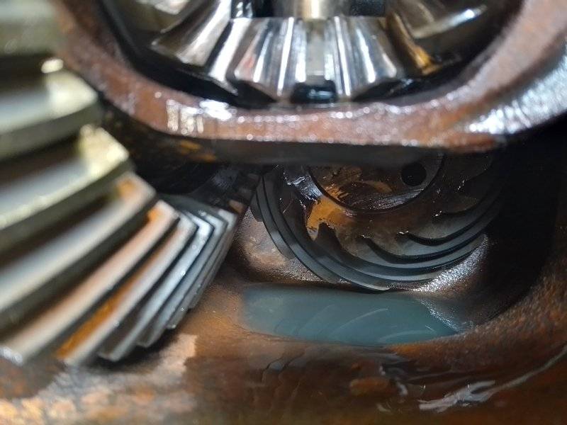

This oil was 25km old, look at the black debris coming from the bearings.

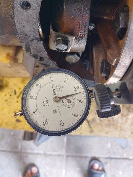

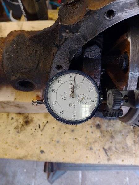

There is some side play at the housing, this could be because of the worn bearings.

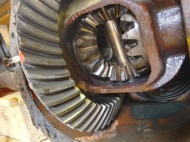

The gear run out isn't that good, but the gears look decent.

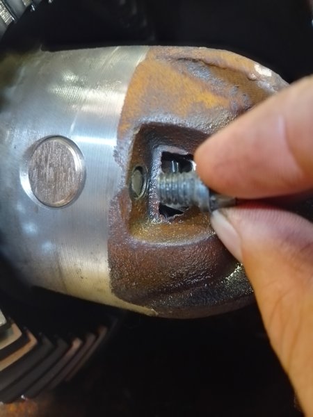

Broke the pinion bolt....
Very good catch. Good idea to check the pinions as well

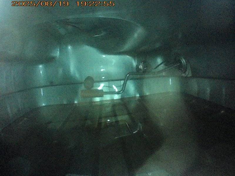

I also found out why the fuel gauge isn't working with 12volts at the sending unit. I borrowed a scope from my work to have a look in the tank.
The sending unit is way too high above the bottom of the tank and also the float is stuck at the front end of the tank.
