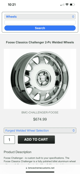

Looking to put a staggered 19x8” front and 20x8.5” rear foose mopar wheels on my 74 Road Runner. Anyone have similar sizes know what offest to get? For the 19’s its a -13 offset or 19 offset, and for Rear 20’s it a -19 or 25 offset. Hoping to not have clearance issue or minimize as much as possible.

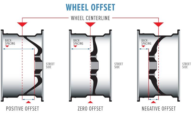

You will need whichever moves most of the wheel to the inside of the car. I don't know or care what the + or - means, tell me the backspace, in INCHES, I'll tell you what will fit.
+/- means hi is the center of the wheel located inside or outside making the back space larger or smaller
