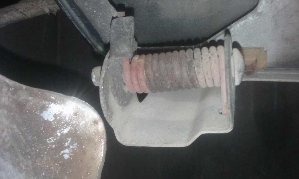

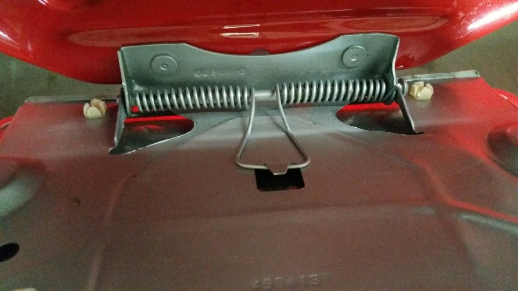

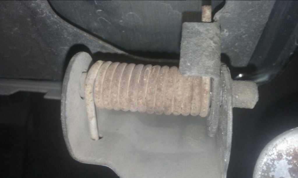

My 72 has 2 springs, 1 on each side. Here are pics.
