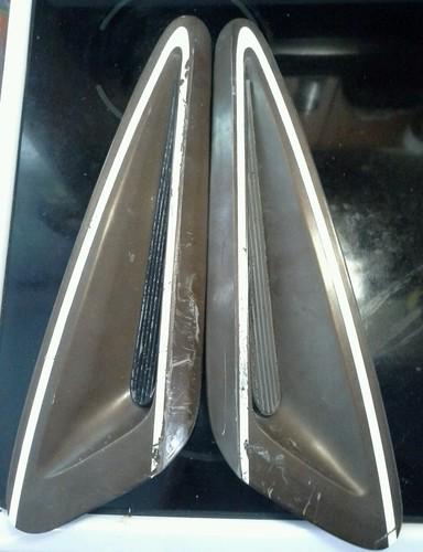

There are actually two inserts for the hood. One is a large piece that attaches to the hood, and the second is a smaller tear drop-shaped piece with ridges that attaches to the large piece. Here's a pic of the large inserts with the smaller ones installed.
These are fake air inlets and do not allow any air in, but you can make them functional. What I've done in the past is remove the small inserts, and then cut out the area they fit into so that area of the larger insert is open. Then I epoxied in some heavy screen mesh that I painted black into the area from behind. This looked great and allowed cool air into the engine bay... not a lot but a little. :)
