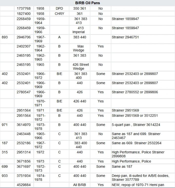

In any case my listing is at home and I'll post the whole thing here so the info is shared with all

Thank you so much. I found the listing
On 440 sources web site. Schumacher sells all of the parts needs. They even said I could get the pan from my Mopar parts dealer. Serves me right for buying a new pan on fleebay. At least it was cheap.
Here tis anyway with the years & apps
PS The yes, no & some column is for baffles

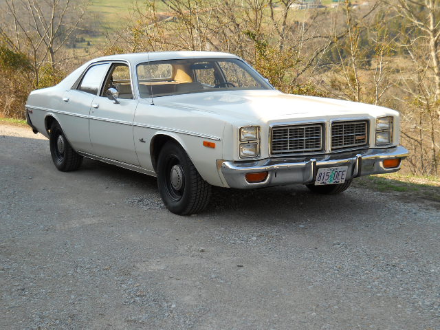

My '77 police package B Body Monaco, 440, etc. It has the stock "971" pan w/windage tray.
