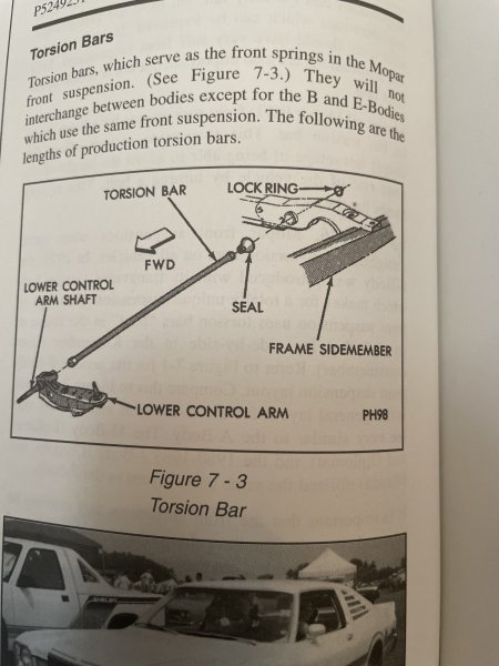

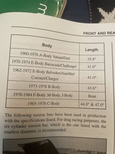

Does any one know the length of the torsion bars for these cars ? Thanks

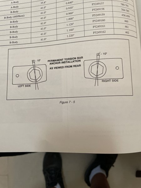

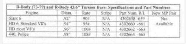

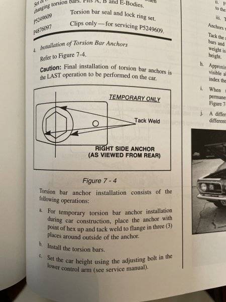

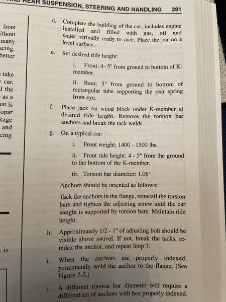

Perhaps this will help?
The T bars are longer in the later years. You would have to use the anchors welded in the front tortion bar circle area to use older T bars.
