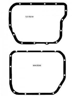

Curious as to what transmission my 1979 Magnum GT has in it? It has a 360 2bbl and 8 1/4 rearend. Not sure if it is A727 or A904. Appreciate any help
Look at your pan.
Problem is that the car has no wheels on it and is sitting low to the ground. Wish I could climb under it and look.
its more than likely a lock up 904. the fender tag will tell you. my 77 360 charger had the 904 behind it. most small block passenger cars were using these by the mid 70's. pretty sure the A998/A999 were available in 79
No chance of a 727?
anything is possible , what rear axle does it have? I know a 727 will go right in without one modification other than a shorter driveshaft, so its possible someone stuck one in there.
You can see the transmission from the top, passenger side. it will be obvious If the corner bulges out. Usually 727 was only 360/400 HP, or towing package.(non lockup) Then you frequently see the 9 1/4 rear as well..
IF it is stock to the car, it can only be 1 trans and1 rear.
904 & 8-1/4. No 727 or larger rear was offered in '79.
