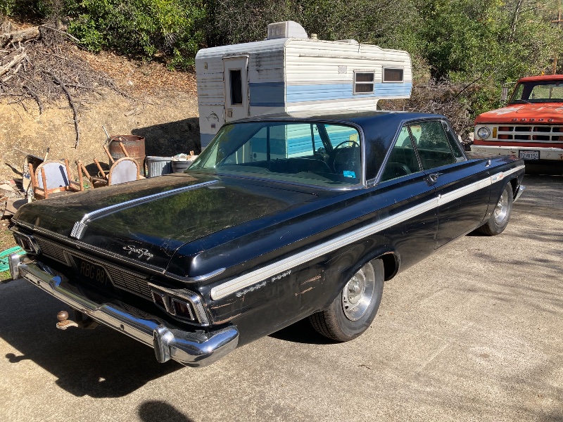

I’m trying to help a friend who doesn’t use the forums find a pair of 15x8 steel wheels that will accept the 9” dog dish hubcaps for his new Fury.
Price shipped to 95695 please.
Seems like the 4” BS would put the tire closer to the fender which might help it look more full with less tire. It’s a survivor 426 wedge car so I don’t think he wants much more than a 275/60r15.

64 or 65? Makes a BIG difference!
Going on the Black 64 in the pic? He'll need the 4 1/2 bs, at least.
I tried to put my 15x8 4"bs wheels, with 255s, on a member here's 64 polara. Wouldn't even come close to fitting. Would have needed at least 5"
Time to do some measuring on the car..... or maybe just settle for 15x7 and 255s.

It’s the 64 in the pic, it’s a survivor car,stock everything except the PO added rallye wheels.
Pull the rear rallye wheel off, and measure the backspace. Check how close the tire is to the spring first. That should give you an idea where the extra width on the wider wheel needs to be.
