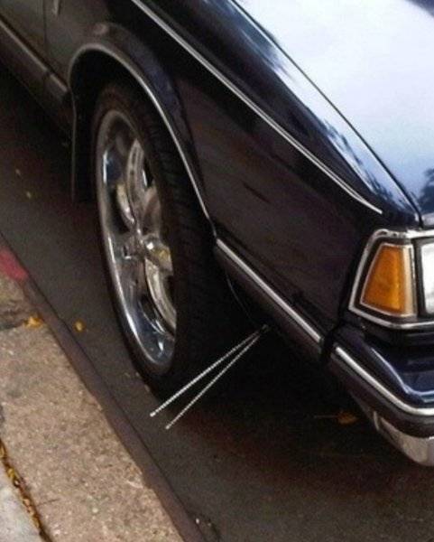

When people say cat whiskers this what I think of.
Basically the same process. The 66-67 B-Bodies used the same clips that were used in the 66 to 70 B-Body hood to cowl seals.
