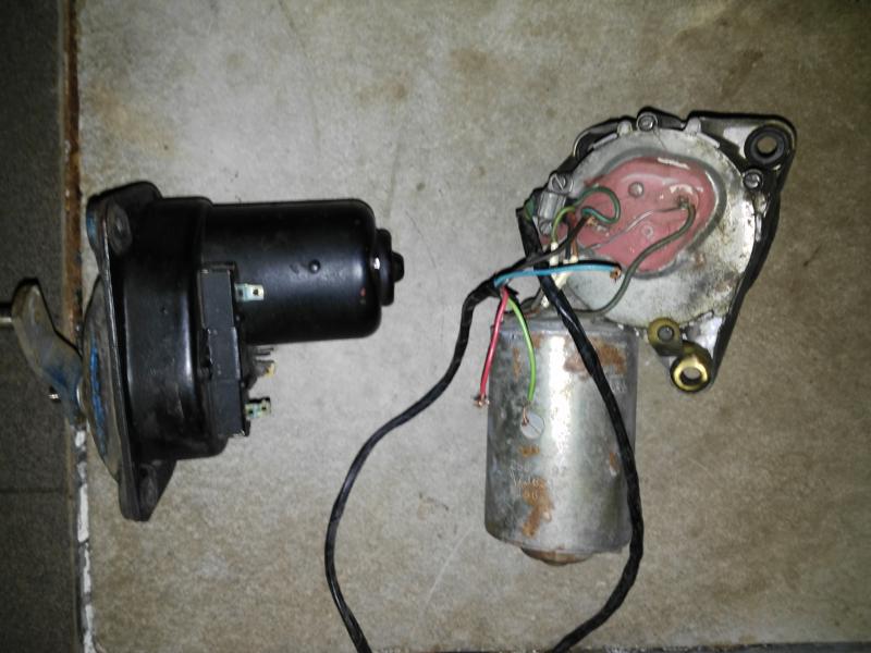

Hey guys, does anyone know how to hook up the electrical wiring from the straight 2 speed motor to the angled 3 speed wiper motor?
If you can make out the colors of the sleeving on the motor winding leads they are
Black,red,yellow and green and a green with rubber insulation. Colors on the harness are dark blue,red,green and brown. They connect as follows black to brown,red to red,green(harness) to yellow
Green(motor) to switch plate along with green rubber from motor and blue to other side of switch plate. These colors are for 68'-70' motors. What year
motor is that in the pic? Kinda looks like a 67'
Hi Beekeeper,
I'm not sure what year the 3 speed is, I bought it on Ebay as a 68.
I will connect those wires as you said and find out.
I'll keep you posted
Thanks bud
