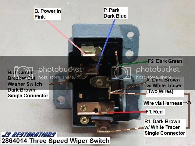

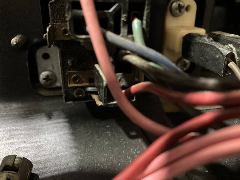

Ok so I am up grading the Road runner to a 3 speed wiper motor, I have the motor, linkage and switch. So what I’m wanting to know is do I need any other wires that come off the back of the switch? And if so where do they go to the bulkhead connector ? Here’s a picture of the back of the 3 speed switch. There are 2 terminals that the connector does not have! All help is greatly appreciated thanks
All wires required are in the dash harness and just taped back .. I'll get on my desk top and try to find you pics..
Ok so I should just cut back the tape on the wiper switch connector and they should be there?
