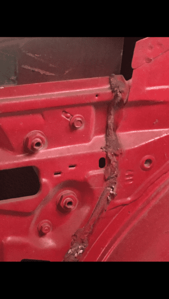

I included some of my own pics of this stuff and as funny as this sounds, I did find a fingerprint in the putty where they clearly mashed this "ball" sealer into this area during its assembly. That does seem to indicate this was once a putty like substance that over time became rock hard. Either this is some special stuff that's no longer available/used or it is similar (if not the exact same) as the stuff we know as strip caulk. And maybe this stuff does get somewhat petrified after years and years and becomes rock hard. The other important point that I had mentioned earlier is that all of these areas were bare metal, including the floor to firewall seam.

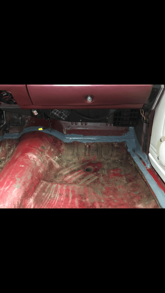

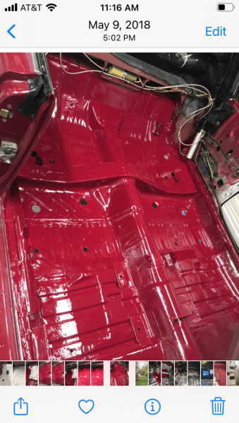

Here the photos from my resealed job. It funny after doing all that work it all gets covered up. But at least the seals are the best they can be.
The pictures got out of order but you’ll figure that out. That first photo shows the sealant with White showing in the disturbed area.
Definitely no paint under the sealant.
An then the top coats and almost finished project, which is/has been completed.

The primer and paint are Rustoleom products applied with a paint brush, two coats each. No spraying.
That looks pretty damn good for brushing. I contemplated doing that as well. Sounds much easier than having to mask everything off and I'm sure the fumes aren't as bad as an aerosol.
