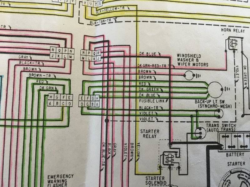

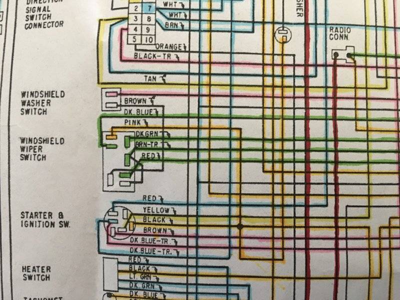

Here’s a couple pics of the factory service manual schematic for a 69’ coronet/Charger
The Brown/white "extra" jumper wire is sitting in the dash harness ready to hook up to go three speed.
