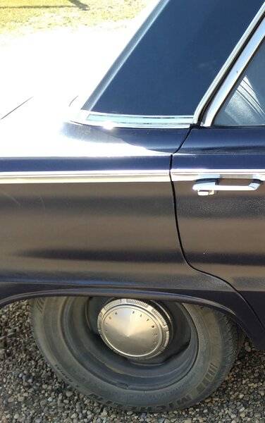

Hi, I'm currently running 215/60Rr15 on my 67 Belvedere...
I have my eyes on a set of 4 215/70R15 and I'm wondering if they would fit without any modifications to the stock suspension or body.

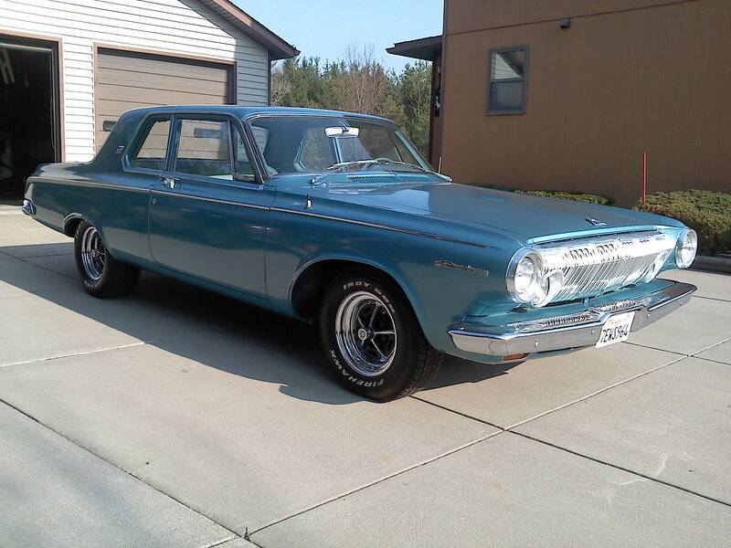

255/70-15's, 8" rims, on my '63 330 Sedan, plenty of room...

I am aware of the DOT ( they were manufactured last year) and they are brand new.
