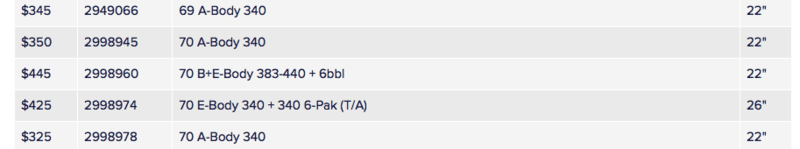

Tony has a 2998960 22" B & E big block listed on his website...
