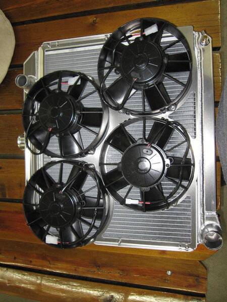

I had Wizard build a 22" for my 540 Indy motor. I told them A/C was in the plan too and let them design and build.

that is awesome fan set up. what is the amp draw with 4 fans with all 4 on ?

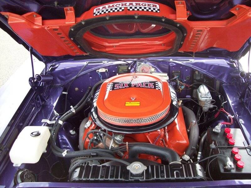

My 440 has fairly high compression and around 500 hp.
It is cooled just fine on even the hottest of days with the factory original radiator, fan, shroud, pulleys and water pump.
View attachment 972686 My 440 has fairly high compression and around 500 hp.

Mine is a 2 row. Rebuilt to oem specs by Glen Ray I believe.
