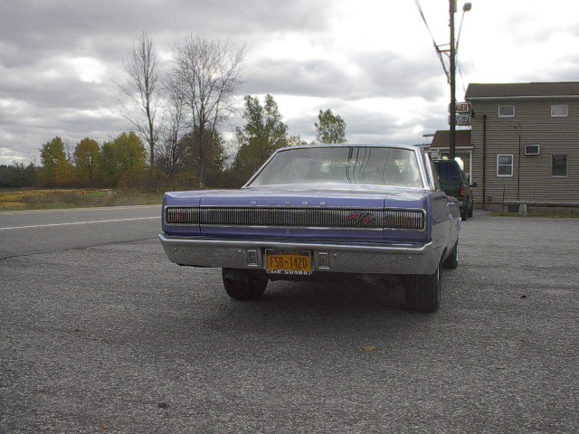

Running 8 inch rims will almost garauntee rubbing. Going to a 7 inch rim will let you bump up to a 255/60 x 15 with ample clearance. It's what I'm running on my `66 Belvedere II. Running 215/70 x 15 on 6 inch front rims. This reduces wear on front end components. Take a look at my photos.
IM001762.JPGsame tires but 7 inch wheels and no issues..8 inch is pressing Your luck
