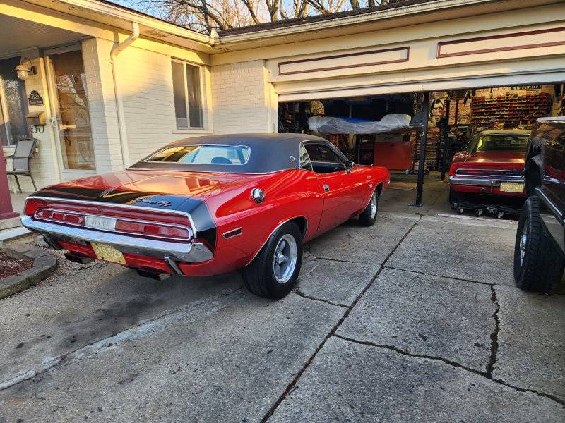

best tire combo? 275/60/15 rear.. 235/60/15 looks short for front.
I like my 255/60 out back, lil more thick. And 235/60 up front.

I currently have 235-60-15 fronts and 275-60-15 rears.
It was suggested to use a 275-60-15 for the spare I believe. BUT if I recall the 275-60-15 will not fit up front.
So what spare tire do you guys run when using different sets front and back AND have Suregrips?

I carry a skinny tire as close as possible to the height of the rear tire. 215/75x15 is only 1/4" shorter than a 275/60. 726 revs/mile vs 721. Take a few pounds out of the 275, and they're the same.
