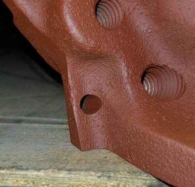

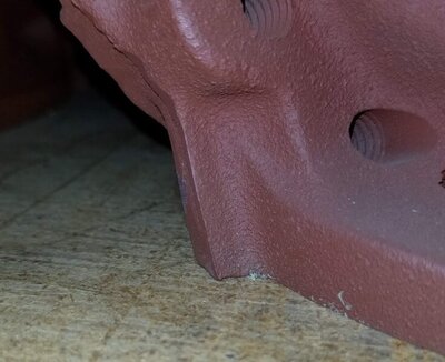

Our description is correct. The difference between the 370/372 bell is the fork spring hole is not drilled in the 370 bh. It can be added if using in the later model cars.
View attachment 1197328 View attachment 1197329
That's for the spring that keeps the fork, adjuster rod and Z bar lever all snugged up correct? Glad you guys that know what you are talking about are around. I would not have noticed it and been stretching the spring to God knows where.
