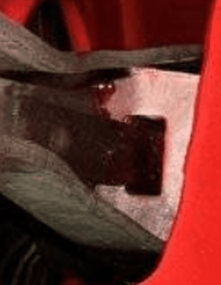

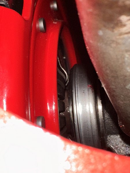

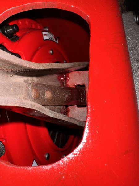

Having trouble keeping the throwout bearing off the clutch fingers after getting the motor and trans back into the car with the lakewood bellhousing
Setup - 69 b body, 440 big block, passon hemi OD a833, lakewood bellhousing, 11" billet flywheel, mcleod twin disc clutch.
After struggling with the ball stud location on the lakewood bellhousing and finally making a custom bracket to get the z bar working correctly I am running into issues with the TO bearing not pulling away from the clutch fingers, the clutch fork seems to pull off/away from the pivot, I am wondering if the spring tab/retainer is worn out? I have the return spring in one of the holes on the bellhousing and its pulling it pretty straight so I think that is alright. I can pull the fork back and it stays and leaves a gap but cycling the clutch leaves it back in contact. The TO bearing moved nicely on the bearing retainer, I did apply a very light coat of grease.

Fork off pivot
TO bearing contacting fingers while fork is off pivot
After pulling fork back onto the pivot
TO bearing pulls away from fingers

It looks like the bracket is to wide and possibly binding on the web of the fork. Where is the return spring attached? If you take the rod off does the spring pull it of the fingers?

It does look like the fork pivot has some conflict.
Looking at the pics a little closer, it looks like the fork is not hitting the pivot in the right spot, the groove where it is supposed to. I may be wrong as its hard to see.

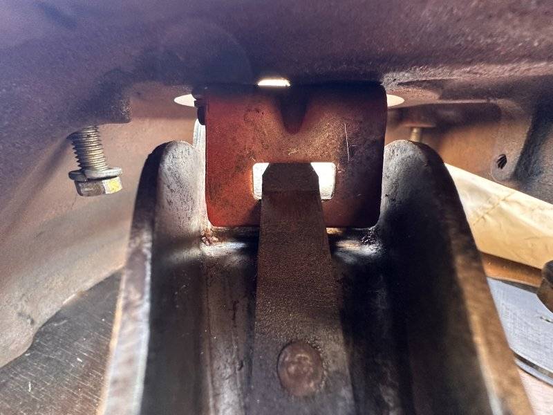

Short story - talked to Dan at Brewers and he feels confident the retaining spring on the clutch fork is worn/bad, he said it should hold the fork to it and mine does not, see photo below of fork on stock bell with stock pivot with bellhousing sitting face down on a table. New fork is on order from brewers.

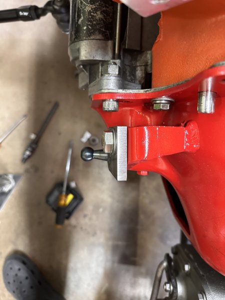

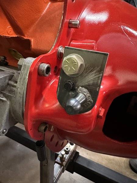

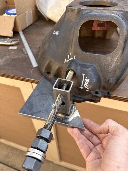

Not really related to this but details on bracket I made and pictures are below, while talking with Dan he said the brackets on the Lakewood bellhousings are inconsistent and can require modification.
My issue was the bellhousing side ball stud was angled up roughly 8 degrees and back roughly 5 degrees, with the z bar installed the tube portion of the bar was almost in contact with the "stem" of the ball stud.
I made a jig that bolted to the face of the stock bellhousing and used a piece of 9/16 all thread to copy the axis the stock ball stud was on. My plan was to not cut anything off the lakewood bellhousing and just make a bracket that I could weld an early b body weld on ball stud to. The location was going to be close to one of the exisiting holes so I did drill an tap a 2nd hole on the lakewood bracket and then bolted a plate to that. From there a friend help me set the entire bellhousing up on his mill and with the jig i made and all thread we dialed in the axis and drilled and counterbored the bracket. From there I just welded it up now the ball stud is in the same location as a factory bell.
Another plus to the early b body weld in stud is it is short them original thread in one which helps getting the Z bar in as I already had to cut a bit off the end.
That looks really good

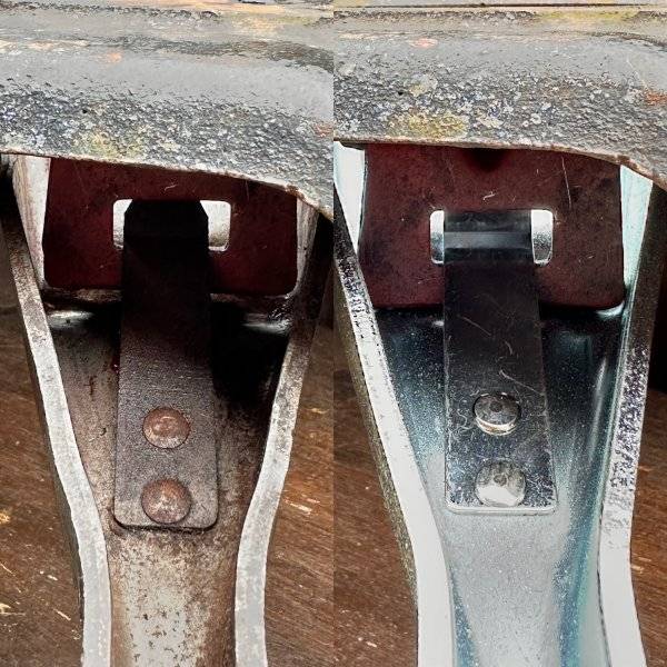

Just to follow up for anyone that might run into this in the future, new fork from Brewers showed up the retainer being bent/worn was 100% the issue, comparison photos below
I drilled the rivets out on my fork, bent the spring back into shape and tapped/screwed it back together. Seems to be holding tight. I would have bought a new fork but other than the bent spring this one looked real good.
Brewers will also refurb/replace the spring on clutch forks, had them do my original one to have on hand.
