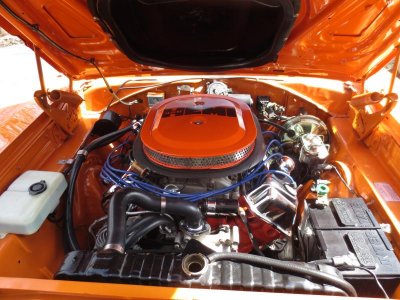

Someone put a 26 in a 70 Hemi Clone RR on a 22 support, for a car that I work on for a guy. Didn't have the shroud initially, but he wanted me to install one. So I did. But the fan was slightly off center on the unit. It worked, but I didn't like the way it looked. Unfortunately, this guy paid a lot of $$ for this car that was all hacked here and there. Ask me how I know. I got a book on this car. LOL. See if I can find some pics.

Here is the 26" rad in my Cuda with a 22" opening. I made brackets to mount using the 22" bolt holes and also use the stock 26" shroud.
