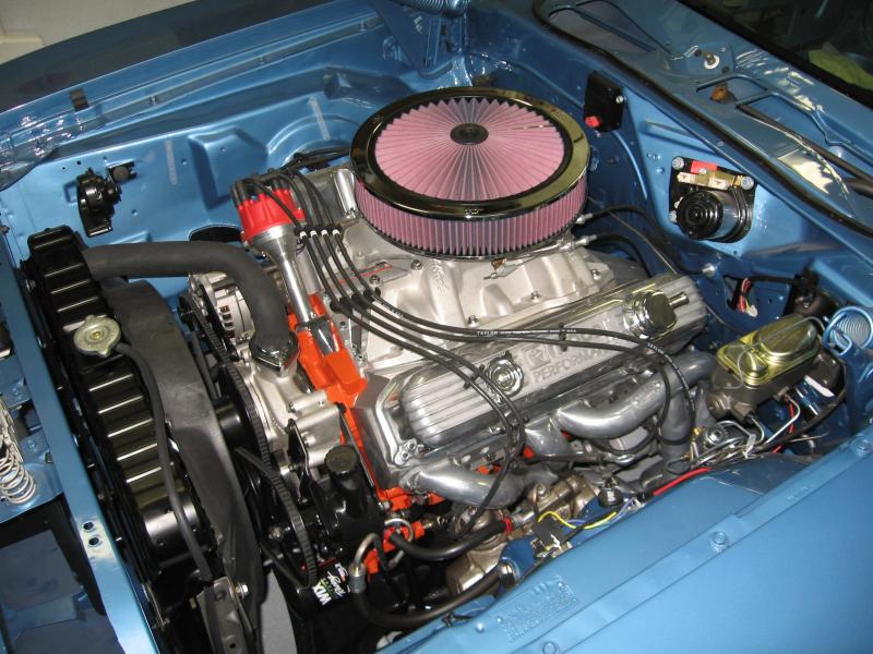

Here is my cheap replacement, with new mopar shroud compliments of Summit racing. Hopefully around mid summer I can afford one of them desert coolers from OER.
26" Was an A/C car so opening is right here is a view.
I have to update, after looking closer at my new cheap rad it was mis advertised and the core size is 24.5" not the 26 or 25.5 is was supposed to be. Plus the top tank is all scratched up got the seller to give me some money back chinese bastards freaking hate them. Was also talking to a different guy about core sizes, he told me the number of rows is less important than the size of the rows. for example a 3 or 4 row rad with only 1/2" rows is less efficient than a 2 row with 1" rows.

My 69 RR came with a 26" radiator mounted to a 22" frame. The shroud ends up centered as Propwash said. You loose about 1" of opening on either side.
I'm in Florida and it cools just fine, but for all I know a 22" would have done the same
I am currently redoing a 68 charger rt, some one cut the radiator support for some unknown reason so i ordered a replacement top and sides didnt realize that they came in 22" and 26", only 26 was available and mine was a 22 anyway the drivers side is the same and the passenger is smaller therefore the opening is not centered so take it out of the passenger side
Someone put a 26 in a 70 Hemi Clone RR on a 22 support, for a car that I work on for a guy. Didn't have the shroud initially, but he wanted me to install one. So I did. But the fan was slightly off center on the unit. It worked, but I didn't like the way it looked. Unfortunately, this guy paid a lot of $$ for this car that was all hacked here and there. Ask me how I know. I got a book on this car. LOL. See if I can find some pics.
The original 68' R/T was a 22" Inch three core radiator. The 26" was A/C. I used an original 22' and recored it as a three core. and the engine doesn't overheat.
Same as my 71 R/T. Sent it to Glen Ray for a rebuild and he said it was a nice core and to save the money and reuse it. Cools the car fine.
Just remember, regardless of the radiator size you end up using, a shroud is a critical piece to help cooling. Without a shroud, air is able to get around the radiator rather than go through it, so you could end up with cooling issues.
All 68 Charger R/T's are 26", ac or not. Anything ac is 26". The radiator support on a 70 is different than 68/69, just sayin....
