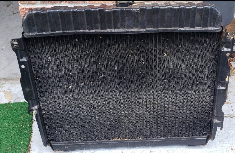

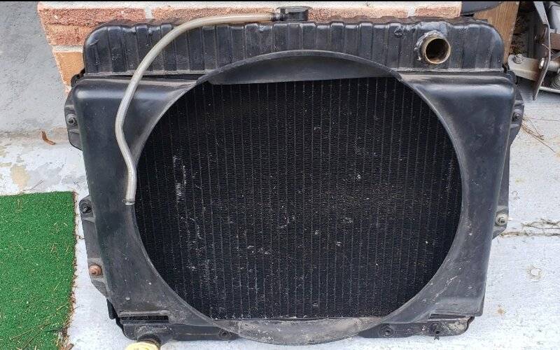

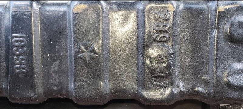

I have absolutely no idea if this is the original factory radiator or not. 1970 real V-code Roadrunner. Factory 4 speed.
The numbers that I think matter I can only make out "289 (something) 047"
26" radiator. See pic. I want to sell it since I have a Cold Case aluminum radiator going in as part of massive number of systems, upgrades, reinforcements, and changes. This one is never going back in, and I sure am not going to hang on to it.

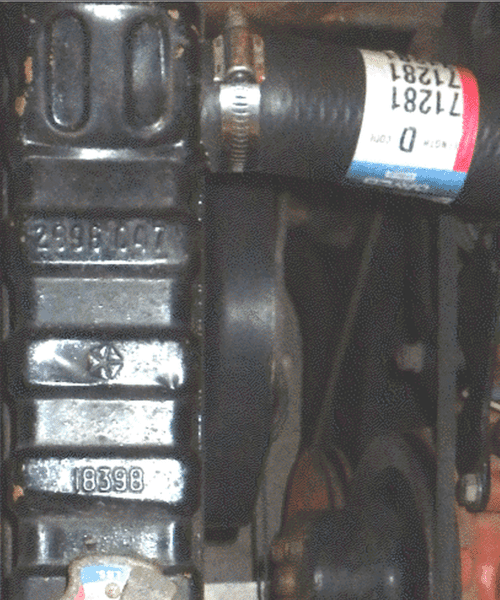

2898047: 1968 B body 26" 383/440 auto/man heater/AC

It's a 1968 440 4 speed radiator. Here's the data:
2898047 1968 B 26" 440 Manual Heater With 492
I don't know what "With 492" means, but this is the description for my radiator.
That is because they copied Galens "White Book". I just didn't include the last part "Inc 492" because I have no clue on what it means. I tried to figure out, but got nowhere. I got mine when I had my Superbee decoded. My book is 5th printing Feb '95

You should have a
2998956 1970 B 26" 426 440 Both Heater
My Galens book is the 8th Edition, dated February of 1999. For the 2898047 radiator it says that the S/C [Sales Code] for this radiator is 492.
This same 26" radiator was used on 1968 440 B body cars with a manual trans with a heater, or a 1968 383/440 automatic with AC [according to Galen].

Yep.
I guess I'll just "guess" how much to ask for it.
If anyone wants to make suggestions on value, I won't be offended.
I'm not surprised, at all, that my FrankenCar has a radiator from a 1968 car.

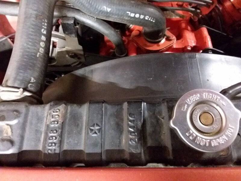

The origional radiator on my 1970 RS23VOA****** is # 2998956. The car was built at the Lynch Road plant the 3rd week of November 1969 as a 1970 model. The car has the A34 super track pack option with the max cooling rad, # 2906070 torque drive fan clutch with shroud, 4.10 Dana 60 rear plus PS-PDB. Hope this helps....

Whats worth the coin on that rad is the tanks n rad supports n shroud,the core can be replaced
