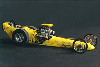

gmp14004.jpg always wanted to build one and this would be my first choice.
