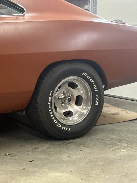

I've ran a set of 275/60/R15 in black steel wheels under my 1970 Charger without issues and under a 1970 Challenger with very minimal trimming of the inner wheel moulding trim.
I now have a 1968 Charger and a set of 15" cop wheels.
Big Question:
Is a 1968 Charger the same as a 1970 Charger as it relates to the rear wheel opening and max tire size ?
I'm going with a 225/70/15 in front and that is an easy fit.
Thanks in advance
Mike

Yes, should be the same and no issue running a 275.
I have P295/50R15's on 15x10's on my 69 Charger, no rubbing on the rear. My fronts are P245/60R15 on 15x8's
275/60/15 here too. I like em
